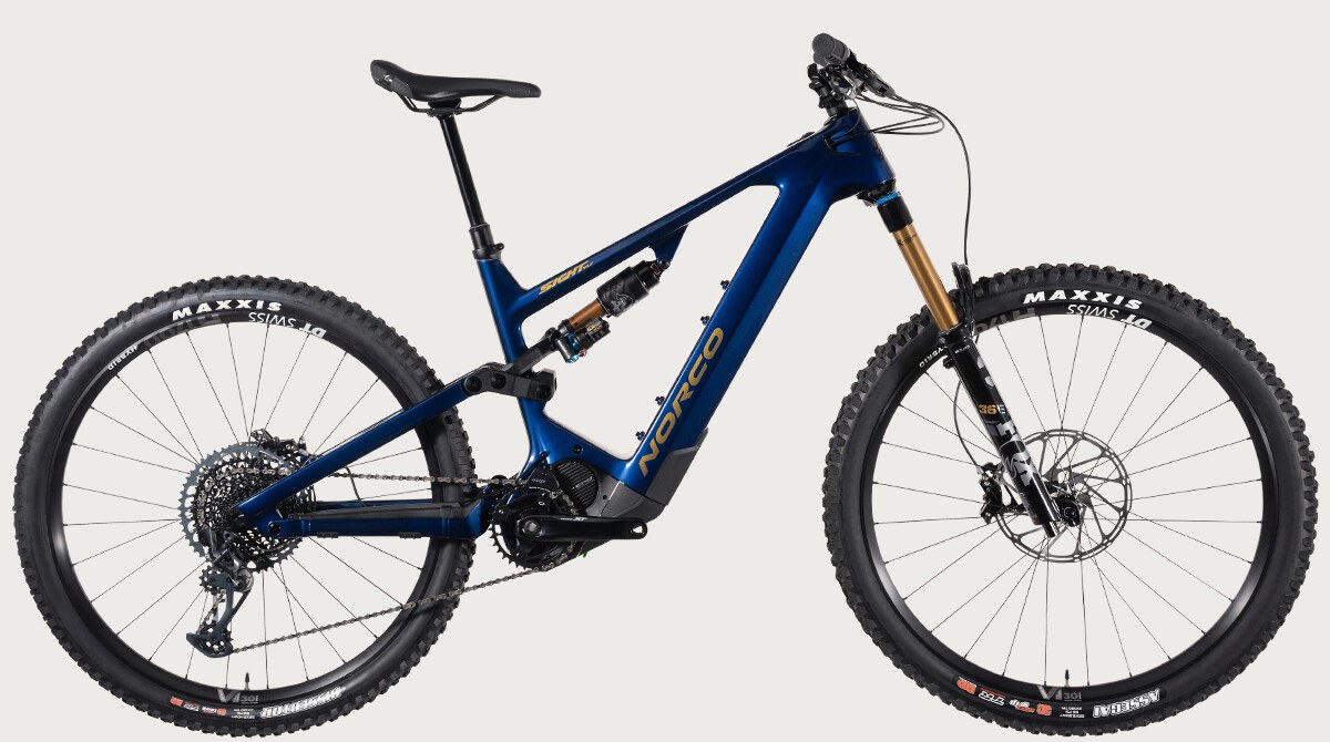

Norco Sight VLT 2023
EMTB Forums verdict
The 2023 Norco Sight VLT is the Canadian brand's full-power all-mountain e-bike, sitting a step below the longer-travel Range VLT enduro machine. It pairs 160mm up front with 150mm of Horst Link travel on full 29in wheels, built around Norco's Ride Aligned geometry with a 64-degree head angle, size-specific seat angles from 77 to 78 degrees and a shared 462mm rear centre across all four sizes.
Power comes from Shimano's STEPS EP8 drive unit (85Nm) feeding a removable Norco VLT in-tube battery, offered in 540Wh, 720Wh and 900Wh capacities so riders can dial range against weight. The big 900Wh pack is among the larger options on an all-mountain platform of this era. Note that Norco listed the battery as a separate purchase from the frame.
Four builds spanned the range: alloy A2 and A1, then carbon C2 and C1. The aluminium A2 and A1 keep things sensible with RockShox 35 Gold or Fox Rhythm 36 forks and Shimano drivetrains, while the carbon C2 steps up to a Lyrik and the flagship C1 goes all-in with Fox Factory 36 GRIP2, Float X2, SRAM Code RSC stoppers on a 220mm front rotor and DT Swiss E 1700 wheels. The alloy trims offer the stronger value; the C1 is a premium statement build.
The Sight VLT was discontinued after the 2023 model year, so it is now a used-market or run-out proposition rather than a current model.

Bike geometry diagram
SMLXL
Reach425 mm455 mm485 mm515 mm
Stack616 mm625 mm634 mm643 mm
Seattube395 mm415 mm440 mm455 mm
Chainstay462 mm462 mm462 mm462 mm
Headtube Angle64°64°64°64°
Seattube Angle (eff)77°77.3°77.7°78°
Wheelbase1224 mm1258 mm1292 mm1327 mm
Headtube100 mm110 mm120 mm130 mm
BB Height350 mm350 mm350 mm350 mm
Standover700 mm703 mm720 mm731 mm
Front Centre762 mm*796 mm*830 mm*865 mm*
FC:RC1.651.721.801.87
