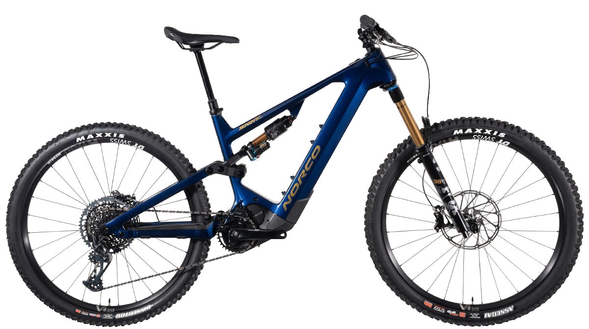

Norco Sight VLT 2022
EMTB Forums verdict
The 2022 Norco Sight VLT is a Gen 3 long-travel All-Mountain eMTB running 160mm up front and 150mm at the rear on a full 29in wheelset, driven by Shimano's STEPS EP8 (DU-EP800) motor. Its headline trick is a modular in-tube battery sold separately from the bike, letting riders choose 540Wh, 720Wh or 900Wh to trade weight against range.
Four builds spanned carbon and alloy frames. The flagship C1 pairs a Fox Factory 36 GRIP2 fork and Float X2 shock with SRAM Code RSC brakes and an X01/GX Eagle mix, while the C2 swaps to RockShox Lyrik Select and a SRAM GX drivetrain. The alloy A1 runs a Fox Rhythm 36 with Shimano SLX, and the A2 uses a RockShox 35 Gold fork with a Shimano Deore build to hit the entry price.
Geometry is aggressive for the class: a slack 64 degree head angle, 462mm rear centre across all sizes and a low 350mm bottom bracket height, with reach growing from 425mm on the S to 515mm on the XL. It is a descending-focused machine built around Norco's Ride Aligned design system.
Geometry read
Size
Descending
69
A solid all-round descender (64° head angle, 150mm) — capable in the rough and steep without being an all-out bruiser.
Playfulness
20
More planted than poppy — better on steep terrain than tight, fiddly singletrack.
Size balance
96
Rear-long with a planted front in L (FC:RC 1.80) — easy to weight the front and quick to turn, though it can feel light at the back at real speed.
Technical climbing
81
Shimano EP8 (DU-EP800) and a steep 77.7° seat angle keep the weight planted over the front — a proper winch. 500W of peak power and 85Nm of torque — a strong full-power motor.
Best suited toBig-day all-rounders who climb a lot and still descend hard.
Strong up and composed down — a do-it-all, not a specialist.
Watch out forNot a flickable, playful bike — built to plough, not pop.
Brilliant on fast, rough, steep terrain; less fun on tight, mellow trails.
