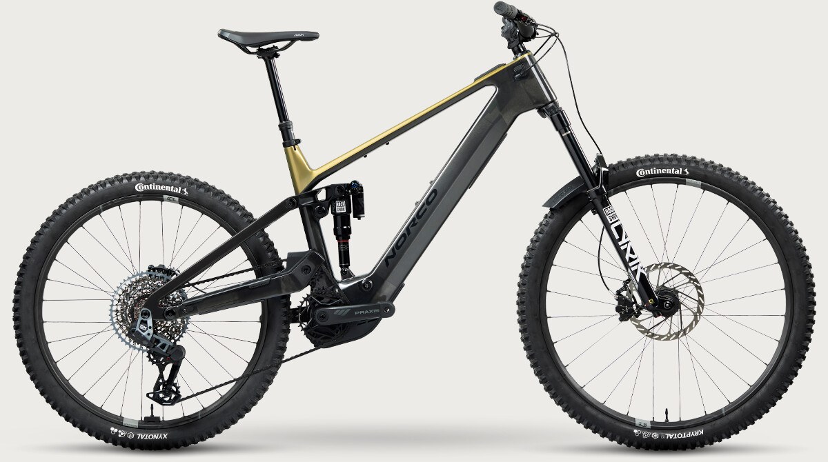

EMTB Forums verdict
Norco's Sight VLT CX is the brand's full-power all-mountain weapon, built around a high-pivot, idler-driven VPSHP layout with 160mm up front and 150mm out back on a mixed 29in/27.5in wheel package. The rearward axle path is aimed squarely at square-edge hits and sustained rough terrain, and Norco gives every frame size its own chainstay length (432mm to 444mm) to keep handling balanced as the bikes grow. Geometry is firmly enduro: a 64-degree head angle, steepening effective seat angles from 77.25 to 78 degrees, and reach stretching from 447.5mm on the size 2 to 522.5mm on the size 5.
Power comes from the latest Bosch Performance Line CX (BDU38) Gen 5 Smart System paired with an 800Wh PowerTube and optional 250Wh range extender. It ships at 85Nm and 600W but unlocks to up to 120Nm, 750W and 600 per cent support through the Performance Upgrade 2.0 in the Bosch eBike Flow app. Norco claims the new platform is almost 20 per cent lighter than the previous Sight VLT while keeping the same battery capacity.
The three-trim ladder is all carbon. The flagship C1 (not sold in the UK) gets RockShox Lyrik Ultimate, a Super Deluxe Ultimate shock, SRAM GX Eagle AXS T-Type wireless shifting, Maven Silver four-piston brakes and Crank Bros Synthesis carbon wheels at a claimed 21.7kg. The mid C2 at £7,799 keeps wireless AXS T-Type and Maven Bronze stoppers but moves to a Lyrik Select+ fork and WTB KOM alloy wheels. The C3 at £6,299 is the value pick, swapping to a mechanical Shimano Deore 12-speed drivetrain, TRP Slate EVO brakes on a 203mm front rotor and a Lyrik Select fork, at a claimed 22.67kg. All three run Continental Kryptotal/Xynotal Enduro Soft rubber and a 800mm bar, so the core ride hardware is consistent across the range.
