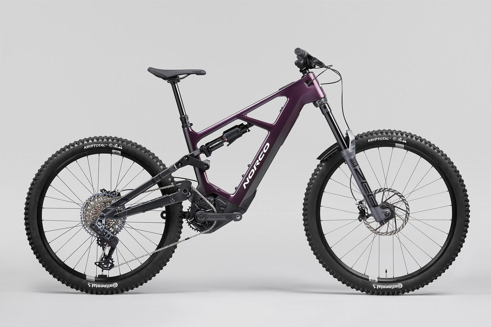

Range 2025
Carbon high-pivot eEnduro platform with Bosch CX Gen 5 power, 800Wh battery and 160/170mm travel.
The Norco Range 2025 is a carbon high-pivot eEnduro flagship with Bosch CX Gen 5 power. Headline numbers: 170mm fork, 160mm rear, Bosch Performance Line CX Gen 5 at 120Nm and 750W peak with a 2.8kg motor mass, a removable 800Wh Bosch PowerTube battery, 25.4kg claimed on the base, 63.0 to 63.5 degree head angle and reach 418 to 528mm across nine size-coded options. Three trims: VLT at GBP 7,399, base at GBP 7,499 and VLT CX C1 at GBP 7,499. @chasmoftheclam's first-ride verdict after taking delivery: "What a composed and quiet bike... I felt like I was riding in slow motion".
Drive system and range. The Bosch Performance Line CX Gen 5 is the headline. 120Nm of torque and 750W peak from a 2.8kg motor, with Bosch's refined PU2.0 firmware. The 800Wh PowerTube battery is removable. @chasmoftheclam highlights an underrated angle: a Bosch 250Wh range extender lifts the package to 1,050Wh effective, meaningful for backcountry and big alpine objectives where charging is not an option. The Bosch ecosystem (Flow app, Kiox display, OTA firmware) is mature and well-supported.
Geometry and handling. 63.0 to 63.5 degrees up front is slack enduro-DH territory. Reach steps are unusually granular: 418 (1), 442 (2), 453 (S), 466 (3), 478 (M), 492 (4), 503 (L), 518 (5), 528 (XL): nine sizes is among the broadest sizing strategies on a long-travel eMTB. Chainstays grow with size from 428 to 450mm, a thoughtful proportional approach. Wheelbase tops out at 1350mm on size 5. The 4-bar high-pivot VPS-HP layout with chainstay idler delivers a rear axle path that sweeps backwards on big hits, smoothing square-edge impacts without sapping pedal response. @chasmoftheclam reports the mullet setup gives "more space to move around the bike during steeper riding" and that the bike "is happier carving corners".
Build and value. Three trims. VLT (GBP 7,399, 23.46kg) pairs Fox 38 or RockShox Zeb at 170mm with a Fox Float X2 or RockShox Vivid Air shock, Shimano XT M8220 or TRP Slate Evo brakes and Shimano XT Di2 or SRAM Eagle Transmission. The (base) trim (GBP 7,499, 25.4kg) and VLT CX C1 (GBP 7,499, 25.4kg) share spec with Fox Float 38 Factory Grip X2 and Fox Float X2 Factory plus Shimano XT M8220 brakes and Shimano XT Di2 12-speed on the CX C1. Standout: high-pivot suspension on a carbon Bosch Gen 5 eMTB at this price is rare. Questionable: 25.4kg claimed is on the heavier side of carbon long-travel rivals.

Frame
Carbon front triangle and rear end (alloy rear on lower tiers), 4-bar high-pivot VPS-HP rear suspension, chainstay idler, mullet 29in/27.5in wheels, internal cable routing, SRAM UDH dropout, Bosch PowerTube 800Wh integration.
