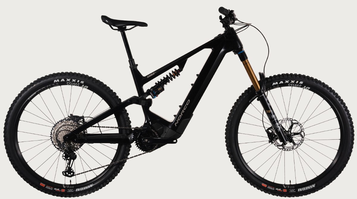

Norco Range VLT 2023
From £6,999
EMTB Forums verdict
The 2023 Norco Range VLT is the Canadian brand's full-power enduro eMTB, built around a Shimano STEPS EP8 drive unit and Norco's customer-selectable in-tube battery (540Wh, 720Wh or 900Wh, sold separately). With 180mm up front and 170mm out back on a 63.0-degree head angle and 1232-1336mm wheelbase, it is unashamedly a Big Mountain and enduro machine rather than a do-everything trail bike.
Norco offered four builds: alloy A1 and A2, and carbon C1 and C2 (carbon front triangle and seatstay over an aluminium chainstay). Every build pairs a coil shock with a burly 38mm or Zeb-class fork and Maxxis Assegai DD tyres front and rear, so even the entry A2 is specced for gravity duty. The carbon C1 is the flagship with Fox Factory suspension and a Shimano XT/XTR mix, while the alloy A1 with Fox Performance 38 and Fox Factory DHX2 coil is arguably the value pick of the range.
The geometry is consistent across all four trims and all four sizes (S to XL, 29in wheels throughout), with long reach figures, a slack head angle and steepening effective seat angles that keep the long-travel platform climbing well under EP8 assistance. The big-battery option list makes range a buyer choice rather than a fixed compromise.
The Range VLT was discontinued after 2023, so it is now a used or end-of-line purchase. As a result, original retail pricing and stock vary, but the spec sheet remains a strong enduro proposition for riders chasing long descents and big days out.
