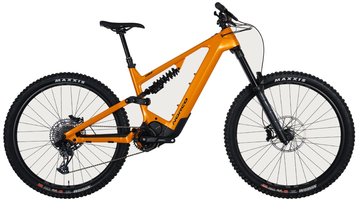

Norco Range VLT 2022
EMTB Forums verdict
The 2022 Norco Range VLT was the Canadian brand's full-power e-enduro flagship, built around Norco's Ride Aligned geometry with 170mm of coil-sprung rear travel and a 180mm fork. Every size runs full 29in wheels, a slack 63.0 degree head angle and a long 462mm rear centre, giving it a planted, big-mountain stance aimed squarely at steep, rough enduro terrain.
Power comes from Shimano's STEPS EP8 drive unit, paired with Norco's unusual sold-separately battery system. Buyers chose a 540Wh, 720Wh or 900Wh in-tube pack, all removable for charging and tool-light swaps, which let riders trade weight for range as needed.
Four builds were offered in 2022. The carbon C1 and C2 use a carbon front triangle and seatstay with an alloy chainstay, while the A1 and A2 are full aluminium. Specs ranged from the C1's Fox Factory 38 GRIP2 fork, DHX2 coil shock and Shimano XT/XTR mix down to the A2's RockShox Zeb RC and Shimano Deore drivetrain, so the platform spanned a wide price and performance range while keeping the same coil-sprung, long-travel chassis.
