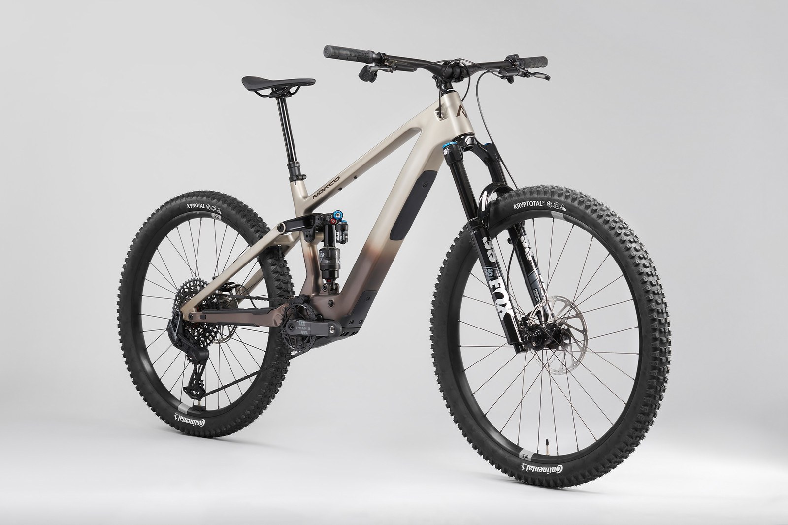

The Norco Fluid VLT 2025 is the Canadian brand's lightweight trail eMTB: a carbon front triangle and carbon stays around 140 mm of rear travel paired with 150 mm of fork, powered by the Bosch Performance Line SX motor at 55 Nm of torque and 600 W peak, and an integrated 400 Wh CompactTube battery. At a claimed 18.5 kg with mullet 29/27.5 wheels and a 64.5 degree head angle, the Fluid VLT positions itself as a lighter, more agile trail alternative to full-power 800 Wh enduros. Norco's Ride Aligned design system gives a size-progressive geometry with chainstays growing 432 mm (S1) to 444 mm (S5).

Fluid VLT Carbon front triangle with carbon seatstays and chainstays, 140mm rear travel, mullet 29in/27.5in wheels, SRAM UDH/Hangerless interface compatible, Bosch CPT 400Wh battery integration, Ride Aligned design system.
