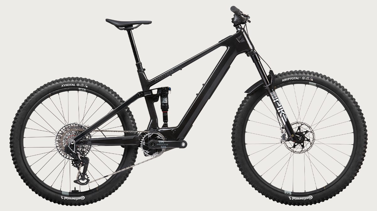

The Fluid VLT is Norco's lightweight, mid-power electric trail bike, built around the Bosch Performance Line SX motor (55 Nm, 600 W peak) and a compact 400Wh internal battery, with an optional Bosch PowerMore 250 range extender. The full-carbon frame (carbon front triangle plus alloy rear on C2 and C3) runs a mullet 29in front / 27.5in rear wheel setup across all five sizes, with size-specific chainstays from 432mm to 444mm. Claimed weights run from 18.1kg on the C1 130 to 20.3kg on the C3.
The range splits into two geometry options on one platform. The headline 140 build pairs a 150mm fork with 140mm rear travel, a 64.5 degree head angle and a 350mm BB height for a planted trail stance. The C1 130 alternative is shorter and steeper at 140mm fork / 130mm rear, a 65 degree head angle and a lower 346.5mm BB, aimed at a more playful, efficient ride.
Spec value steps up cleanly through the range. The C3 at GBP 5,999 runs a RockShox Psylo Gold fork and Shimano Deore 12-speed with TRP four-piston brakes. The GBP 7,999 C2 is offered in three fork choices (RockShox Lyrik Select+, Fox 36 Rhythm or Fox 36 Performance Elite) with SRAM GX AXS T-Type wireless shifting. The GBP 9,999 C1 140 adds a Fox FLOAT X2 shock, SRAM X0 AXS, Code brakes and Crank Brothers wheels. The flagship C1 130 (sold in mainland Europe at EUR 12,999) goes to SRAM XX SL AXS, carbon wheels and a full RockShox Pike Ultimate package.
