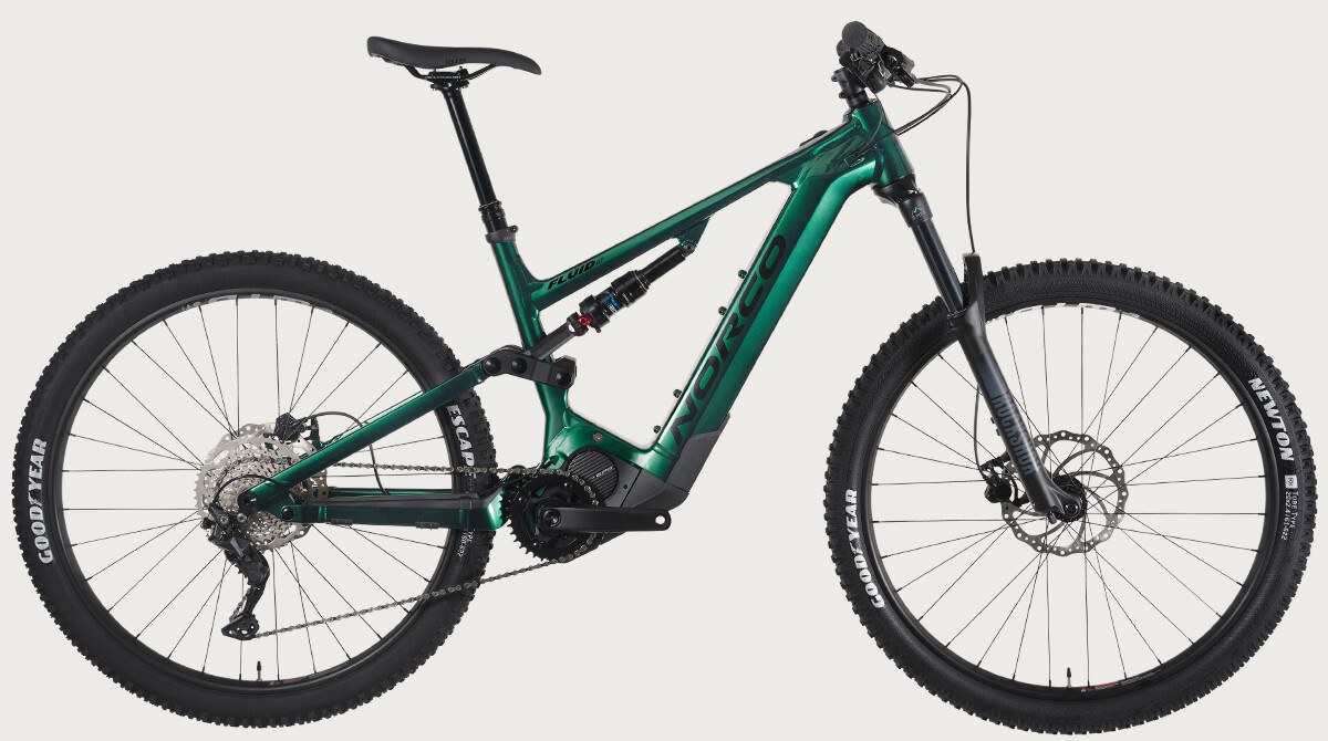

Norco Fluid VLT 2023
EMTB Forums verdict
The 2023 Norco Fluid VLT was the brand's full-power alloy trail eMTB, built around a hydroformed aluminium frame with 140mm of fork travel and 130mm at the rear. It ran Shimano's STEPS EP8 (DU-EP800) drive unit paired to a removable in-tube battery that buyers could custom select in 540Wh, 720Wh or 900Wh capacities, trading weight against range. Norco's Ride Aligned setup system guided suspension and fit.
Two builds covered the range. The A1 was the better specced of the pair, with a 12-speed Shimano Deore drivetrain, four-piston Shimano MT420 brakes on 203mm rotors and Maxxis Dissector tyres. The A2 dropped to a 10-speed Shimano Deore setup, Tektro HD-M285 brakes and Goodyear Newton/Escape tyres, with both builds sharing the RockShox 35 Silver coil fork and a sensible 800mm bar and 50mm stem.
Geometry was steady and trail oriented rather than aggressive, with a 65 degree head angle, 462mm chainstays across all four sizes (S to XL) and reach from 410mm to 500mm on consistent 29in wheels. It positioned itself as a dependable, value led full-power option rather than a lightweight flyer.
This alloy generation has been discontinued and was superseded by the lighter, redesigned 2024 Fluid VLT, which moved to a Bosch Performance Line SX motor, a smaller internal battery and an MX wheel layout. The two bikes share a name but little else.
