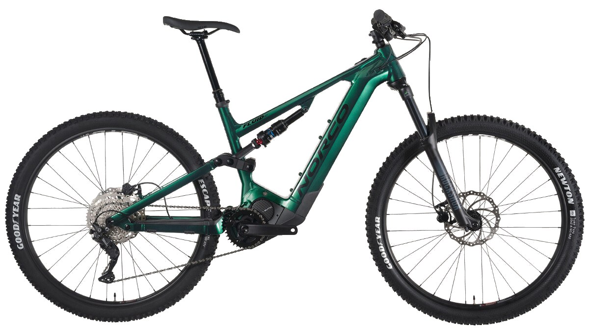

The 2022 Norco Fluid VLT was the brand's full-power alloy trail eMTB, built on a hydroformed aluminium frame with 140mm of fork travel and 130mm at the rear. It ran Shimano's STEPS EP8 (DU-EP800) drive unit, and true to Norco's Choose Your Juice approach the in-tube battery was sold separately so riders could pick 540Wh, 720Wh or 900Wh capacity, trading weight against range. The Ride Aligned system guided suspension and fit.
Two alloy builds made up the 2022 range. The A1 was the higher-specced of the pair with a 12-speed Shimano Deore drivetrain, four-piston Shimano MT420 brakes on 203mm rotors and Maxxis Dissector tyres. The A2 stepped down to a 10-speed Shimano Deore setup, Tektro HD-M285 brakes and Goodyear Newton and Escape tyres, with both builds sharing a RockShox 35 Silver fork, an 800mm bar and a 50mm stem.
Geometry was steady and trail focused rather than aggressive, with a 65 degree head angle, 462mm chainstays across all four sizes (S to XL) and reach growing from 410mm to 500mm on consistent 29in wheels. It sat as a dependable, value led full-power option rather than a lightweight flyer.
This alloy generation has been discontinued. It was later superseded by the redesigned 2024 Fluid VLT, which switched to a lightweight Bosch Performance Line SX motor, a smaller internal battery and an MX wheel layout. The two bikes share a name but little else.
