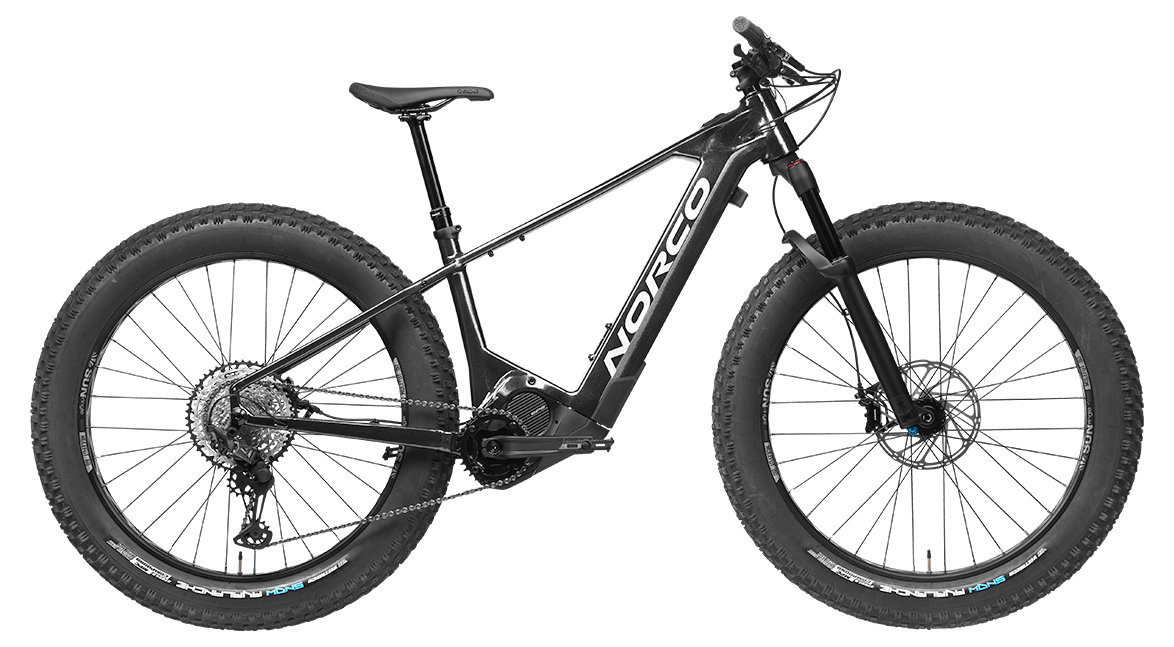

The 2023 Norco Bigfoot VLT was the Canadian brand's electric fat-bike hardtail, built around a butted X6 aluminium frame and Shimano's EP8 drive unit. Norco fitted a removable in-tube battery and let riders pick their range at the configurator, with 540Wh, 720Wh and 900Wh options sold separately from the bike. It came in two builds: the VLT 1 with a Manitou Mastodon Pro EXT 100mm suspension fork and an XT/SLX 12-speed mix, and the cheaper VLT 2 with a rigid 6061 aluminium fork and a Deore drivetrain.
This is a genuine off-road machine rather than a beach cruiser. Both builds roll on 27.5 x 4.5in Vee Snow Avalanche studdable tyres on Sun Ringle Mulefut SL rims, with powerful SRAM four-piston brakes (DB8 on the 1, Code R on the 2) and a 203mm front rotor. Reasonably modern hardtail numbers back that up: a 68 degree head angle and 1254mm wheelbase in XL on the VLT 1, dropper posts across the range, and Norco's stated aim of modern MTB handling through treacherous, cold-weather terrain.
As a fat eMTB it is firmly an adventure and winter-traction tool rather than a trail-shredder, with the tall fat-bike bottom bracket and limited 100mm of front travel setting expectations. Native bike-only pricing was USD 5,999 for the VLT 1 and USD 4,999 for the VLT 2, with the chosen battery on top, so value is fair for a name-brand fat e-bike.
