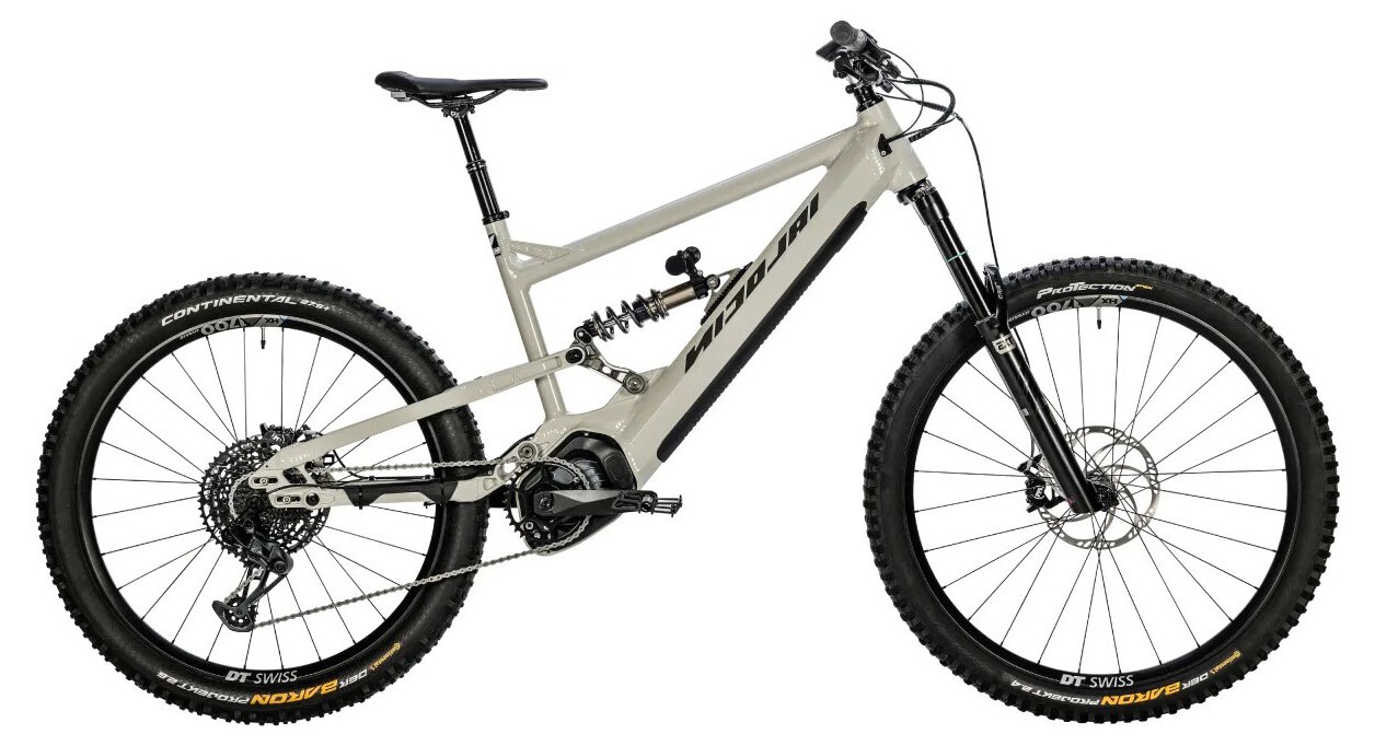

The Nicolai G1 Eboxx 2024 is a German hand-welded enduro/DH eMTB and Nicolai's eMTB flagship. Headline numbers: 160mm fork, 160mm rear, Bosch Performance Line CX Gen 4 at 85Nm and 600W peak with a 2.9kg motor mass, a removable 750Wh Bosch PowerTube battery, 62.5 degree head angle and reach 470 to 555mm across S, M, L, XL and XXL. Priced from EUR 9,499 base. Nicolai's design language is unmistakable: hydroformed 7020-T6 aluminium, sliding rear dropouts for mullet or 29in setups and reach numbers that begin where most rivals end. @Mcharza (a motors specialist on the forum) confirms the long heritage of Bosch Performance CX power on this platform.
Drive system and range. The Bosch Performance Line CX Gen 4 delivers 85Nm of torque and 600W peak, with a refined dynamic mode that ramps assist naturally. The 750Wh PowerTube battery is removable through the downtube. Real-world range on a 160/160mm bike with 750Wh sits at two to three hours of mixed alpine riding, with 1,500 to 2,200m of vertical achievable. Bosch's Flow app, Kiox 300 display and firmware updates are all standard. The Bosch-Nicolai ecosystem is mature: hand-welded German aluminium plus a proven, well-supported eMTB drive unit is a serious pairing.
Geometry and handling. 62.5 degrees up front is exceptionally slack: properly DH-grade and well beyond mainstream enduro convention. Reach steps are enormous: 470 (S), 495 (M), 515 (L), 535 (XL), 555 (XXL): these numbers start where most rivals top out, designed for riders who think they need a 510mm reach. Chainstays grow with size from 446 to 458mm. Wheelbase tops out at 1371mm on XXL. The Slide AFE sliding dropouts allow chainstay-length adjustment and switching between mullet 29/27.5 and full 29in setups without frame swap. This is geometry for fast, steep terrain, not tight trail-centre singletrack.
Build and value. One base trim at EUR 9,499. The build is serious: EXT e-Era fork with floating-shaft technology, high/low-speed compression and rebound adjust at 160mm; EXT e-Storia coil shock with hydraulic bottom-out (230x65mm); Magura four-piston brakes with Magura rotors; SRAM GX Eagle 12-speed. EXT suspension is the German alternative to Öhlins: handmade in Italy, properly tunable, and very rare on factory-built eMTBs. Standout: hand-welded German frame plus EXT suspension plus proven Bosch CX power in one package. Questionable: aluminium-only at premium pricing; no entry-level trim option.
