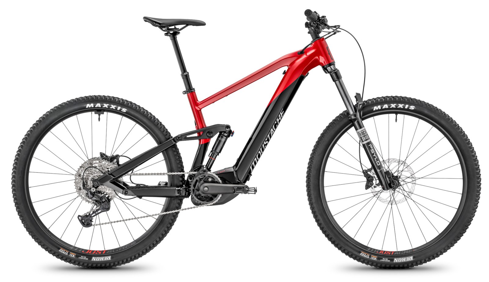

The Samedi 29 Trail 150 is Moustache's full-power aluminium trail platform, running 150mm of travel front and rear on full 29in wheels around the Bosch Performance Line CX motor and a removable PowerTube battery (625Wh as standard, 750Wh optional). The in-house Magic Grip Control shock with its two-position platform is the centrepiece, paired with a RockShox Psylo air fork.
Geometry is consistent and conventional across the four sizes: a 65.6 degree head angle, 76.6 degree effective seat angle and a fixed 462mm rear centre on every size, with reach growing from 441mm (S) to 512mm (XL). That points to a measured, balanced trail bike rather than a slack enduro machine, and the 350mm BB and 150mm travel suit varied terrain rather than bike-park abuse.
The Trail 150.2 at £3,599 covers the essentials with a Shimano CUES 11-speed drivetrain, Magura MT5 four-piston brakes on 203mm rotors and the Psylo Silver R fork. The Trail 150.4 steps up to a Shimano XT 12-speed mech, an upgraded Psylo Silver RC fork with lockout, and a longer 170mm dropper, while keeping the same frame, motor and suspension.
Both share the same frame, motor, suspension and geometry, so the choice is between the simpler CUES-equipped 150.2 and the better-shifting XT-equipped 150.4. Moustache also offers an SUV equipment option (lights, mudguards and a QL3 rack) for riders wanting commuter capability.
