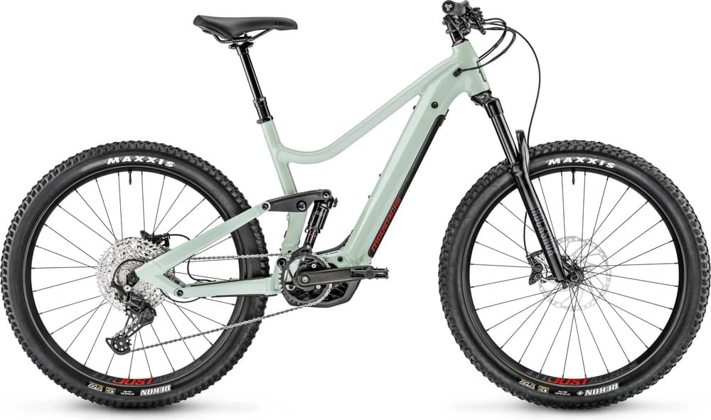

The 2022 Moustache Samedi 27 Wide is the French brand's comfort-focused 27.5in trail eMTB, built on a hydroformed 6061 aluminium frame with 130mm of fork travel and 120mm at the rear. Power comes from the Bosch Performance Line CX (85Nm), and the standout feature is Moustache's own Magic Grip Control air shock, a 2-position platform unit with dynamic rebound control designed to keep the front wheel planted on steep climbs. All three trims run 27.5x2.80in Maxxis Rekon plus tyres for grip and cushioning.
The range is a simple three-rung ladder. The Wide 2 (23.1kg, 500Wh) uses a Suntour XCR34 fork with an 11-speed Shimano Deore drivetrain and MT410 brakes at 4,099 GBP. The Wide 4 (24.1kg, 625Wh) steps up to a RockShox 35 Silver coil fork and mixed MT420/MT410 brakes at 4,499 GBP. The Wide 6 (23.5kg, 625Wh) tops the range with a Fox Float 34 Rhythm fork, a 12-speed Deore drivetrain and four-piston MT420 brakes front and rear at 5,099 GBP. Every trim carries 203mm rotors and a KS dropper.
Geometry is shared across the family and leans towards easy handling rather than aggression: a 73-degree seat angle, a 66 to 66.5-degree head angle, a low 345mm BB height and short 458mm chainstays across all four sizes. Reach spans a modest 386mm (S) to 458mm (XL). This is a stable, accessible trail bike rather than a steep-and-slack enduro machine.
The Samedi 27 Wide has since been discontinued and replaced within Moustache's range. Moustache had limited UK distribution, so second-hand availability here is thin. There is no forum owner data in Greg's records for this model, so the notes above are drawn from the manufacturer's published specification and geometry only.

MotorBosch Performance Line CX Gen 4 · 85 Nm · all trims
BatteryBosch PowerTube 625 · 625 Wh · all trims
Travel F/R130/120 mm · all trims
FrameAluminium 6061 T4-T6 (hydroformed, variable-thickness tubes) · all trims
ForkSuntour, XCR 34, air spring/coil, w/ preload & lockout function, 130mm travelRockShox, 35 Silver R - plush Coil spring w/external rebound, 130mm travel, 15x110mm, Boost, 51mm OffsetFOX, Float 34, Rhythm, Grip, Sweep-Adj, 130mm travel, 15x110mm, Boost, 51mm Offset
ShockMoustache, Magic Grip Control 120, specific Air Shock with 2-position platform and dynamic control of rebound, Trunion mount, build-in 165x45mm, 120mm travel · all trims
HeadsetFSA, No 57B · all trims
StemMoustache, Alloy 3D forged, 60mm · all trims
HandlebarMoustache, Alloy 740mm, 15mm rise, 9° backsweep, 5° upsweep · all trims
GripsSB3, Race One Lock · all trims
SaddleMoustache, Comfort · all trims
SeatpostKS-900I, dropper-post w/remote lever, 31.6mm. Size S=330mm w/100mm travel, M=380mm w/125mm travel, L=430mm w/150mm travel, XL=430mm w/150mm travel · all trims
BrakesShimano, MT410 hydraulic disc brakesShimano hydraulic disc brakes: MT420 4 piston front - MT410 2 piston rearShimano MT420 hydraulic 4 piston disc brakes, front & rear
Rear derailleurShimano, Deore, RD-M5100-SGS, 11-speedShimano, Deore, RD-M5100-SGS, 11-speedShimano, Deore, RD-M6100-SGS, 12-speed
CrankMoustache, Alloy, 170mm (FSA 34T optimized Narrow Wide chainring, direct mount)Moustache, Alloy, 170mmFSA, forged aluminum, 165mm
ShiftersShimano, Deore, SL-M5100 Rapidfire PlusShimano, Deore, SL-M5100 Rapidfire PlusShimano, Deore, SL-M6100-R, 12-speed, Rapidfire Plus
CassetteShimano, Deore, CS-M5100-11S, 11-51TShimano, Deore, CS-M5100-11S, 11-51TShimano, Deore, CS-M6100-12S, 10-51T
ChainSRAM, PC1110, 11-speed w/PowerlockSRAM, PC1110, 11-speed w/PowerlockShimano, CN-M6100, 12-speed
DrivetrainShimano, Deore, RD-M5100-SGS, 11-speed; Moustache, Alloy, 170mm (FSA 34T optimized Narrow Wide chainring, direct mount); Shimano, Deore, SL-M5100 Rapidfire Plus; Shimano, Deore, CS-M5100-11S, 11-51T; SRAM, PC1110, 11-speed w/PowerlockShimano, Deore, RD-M5100-SGS, 11-speed; Moustache, Alloy, 170mm; Shimano, Deore, SL-M5100 Rapidfire Plus; Shimano, Deore, CS-M5100-11S, 11-51T; SRAM, PC1110, 11-speed w/PowerlockShimano, Deore, RD-M6100-SGS, 12-speed; FSA, forged aluminum, 165mm; Shimano, Deore, SL-M6100-R, 12-speed, Rapidfire Plus; Shimano, Deore, CS-M6100-12S, 10-51T; Shimano, CN-M6100, 12-speed
WheelsMoustache asymmetric, Alloy 6061E, welded, double wall, 28 holes, 27.5", 35mm width, mounted with Tubeless valves & flap · all trims
TyresMaxxis Rekon 27.5x2.80, foldable, Tubeless Ready · all trims
Weight23.1 kg24.1 kg23.5 kg
Price£4,099£4,499£5,099
