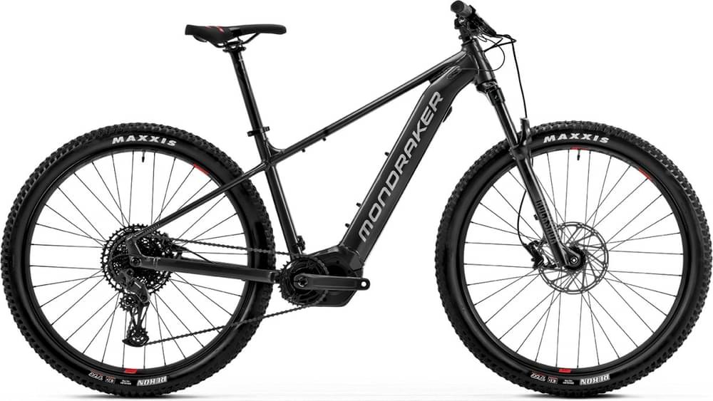

Mondraker Thundra 2022
EMTB Forums verdict
The 2022 Thundra is Mondraker's alloy e-hardtail, the Shimano-powered sibling of the Prime. It runs a Shimano STEPS E7000 motor (60Nm) fed by an internal, non-removable Simplo 630Wh battery, with an optional Simplo 360Wh external range extender. The frame is Mondraker's Thundra Xtralite 6061 alloy built around their signature Forward Geometry, on 29in wheels with zero rear travel.
Two builds shared the platform. The standard Thundra is the trail-focused option, with a 120mm RockShox Recon fork and grippy Maxxis Rekon 29x2.6 tyres at a claimed 22.4kg. The Thundra X is the urban and lifestyle variant, dropping to a 100mm fork on fast-rolling Maxxis Grifter semi-slicks and adding lights, mudguards, a rear rack and kickstand, at a claimed 23.9kg.
Both trims share a mid-tier SRAM SX Eagle 1x12 drivetrain and SRAM Level T brakes, so this was pitched at value rather than outright performance. The Thundra is now discontinued, but as a straightforward, lighter alloy e-hardtail it remains a sensible do-it-all commuter and light trail machine.
