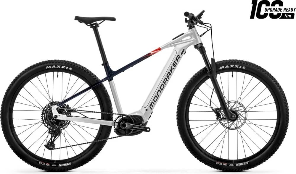

Mondraker Prime 2024
From £3,699
EMTB Forums verdict
The 2024 Mondraker Prime is the brand's full-power 'Sport' e-MTB: a 29in aluminium hardtail trail eMTB built on Mondraker's Xtralite 6061 frame and Forward Geometry. It is deliberately straightforward, a 120mm RockShox fork up front and no rear suspension, designed as a value, all-conditions trail bike rather than a long-travel enduro machine.
Power comes from a Bosch Performance Line CX Gen 4 motor (85 Nm, 600 W) run through an Intuvia 100 display and Mini Remote. The base Prime carries a removable Bosch PowerTube 625Wh battery, SRAM SX Eagle 12-speed gearing, SRAM Level T 2-piston brakes and Maxxis Rekon 29x2.6 tyres on Mavic E-CrossRide wheels, with a rigid Onoff post. The Prime R steps up to a 750Wh battery, a remote-lockout RockShox Recon Gold fork, SRAM DB8 4-piston brakes and an Onoff Pija dropper.
Geometry is moderate by modern eMTB standards, a 69 degree head angle, 73.5 degree seat angle and 455mm chainstays across the range, with reach growing from 410mm to 505mm. Claimed weight is around 22.7kg. UK RRP was 3,699 GBP for the base Prime and 4,099 GBP for the Prime R.
Two further trims wore the Prime name in 2024, the Prime RX and the separate Prime X, but both are urban-cross / commuter builds on slick-ish Maxxis Grifter tyres and an urban cockpit, so they sit outside this trail-eMTB record.
