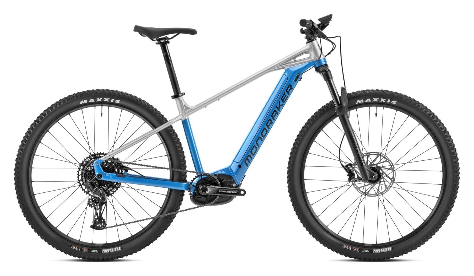

Mondraker Prime 2023
From £3,499
EMTB Forums verdict
The 2023 Mondraker Prime is the brand's full-power aluminium hardtail trail eMTB, sitting in Mondraker's entry-level SPORT category. It pairs a proven Bosch Performance Line CX Gen 4 Smart System motor (85Nm, 600W) with a 120mm RockShox fork, a 29in alloy frame and Mondraker's signature long Forward Geometry. At a 69 degree head angle, 73.5 degree seat angle and reaches from 410mm (XS) to 505mm (XL), it is roomy and stable for a hardtail without straying into aggressive enduro territory.
Value is the story here. The base Prime launched at GBP 3,499 with a 625Wh battery, the urban-flavoured Prime X at GBP 3,699, while the Prime R and RX climbed to GBP 3,899 and GBP 4,099 and added a larger 750Wh pack, four-piston SRAM DB8 brakes and a dropper post. All four share the same frame and geometry, so the choice comes down to range, stopping power and whether you want trail-biased Maxxis Rekon rubber or the more road-oriented tan-wall Grifters of the X and RX.
Specced sensibly rather than lavishly, with a SRAM SX Eagle drivetrain and own-brand Onoff and MDK finishing kit, the Prime is squarely aimed at riders wanting an affordable, dependable route into Bosch full-power assistance for fitness, commuting and easy-to-moderate off-road riding. It is not a technical descender, but as a no-fuss hardtail it does its job well.
This 2023 model is now discontinued. The Prime name lives on in Mondraker's current range, where later generations have moved to the newer Bosch CX platform, so the 2023 bike is best viewed as a value used or run-out buy rather than a current showroom option.
