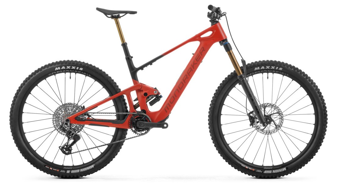

The Neat is Mondraker's full-carbon light e-MTB, built around the lightweight TQ HPR-50 motor (50 Nm) with a 360Wh integrated, removable battery and an optional 160Wh range extender. With 160mm up front and 150mm out back on the updated Zero Suspension System, it sits at the enduro-capable end of the lightweight category rather than chasing all-out range.
Geometry is consistently aggressive across the four sizes, with a 64.5 degree head angle, 76.5 degree effective seat angle and 450mm chainstays at every size. Reach runs from 450mm on the S to 515mm on the XL, reflecting Mondraker's Forward Geometry philosophy of long front centres and short stems (a 30mm Onoff unit throughout).
The three trims share frame, geometry and motor, so the choice is purely about kit and weight. The R (£7,399) pairs a RockShox Lyrik/Super Deluxe with SRAM DB8 brakes and S1000 AXS at a claimed 18.9kg. The RR (£8,499) steps up to Fox 36 Factory/Float X, Shimano XT four-piston brakes and GX AXS at 18.7kg. The RR SL (£10,499) tops the range with XTR brakes, XX Eagle AXS, carbon Mavic wheels and a Reverb AXS dropper at a claimed 18.3kg.
For most riders the RR is the value sweet spot, bringing the Factory-level Fox suspension and XT braking that define the bike's descending intent without the considerable jump to the SL's drivetrain and wheel upgrades.
