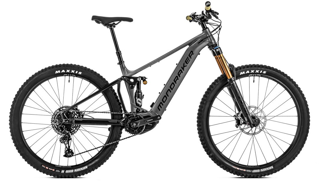

Mondraker Dusk 2024
EMTB Forums verdict
The 2024 Mondraker Dusk was the brand's aluminium full-power enduro eMTB, built around the Zero Suspension System with 150mm of rear travel, a 160mm fork and Mondraker's signature long-reach Forward Geometry. The two-trim 2024 range, Dusk S and Dusk SR, shared a 6061 Alloy Stealth Evo frame, a Shimano STEPS EP600 motor (85Nm) and a non-removable 720Wh internal battery, with an optional 360Wh range-extender for bigger days.
Geometry was identical across both trims and four sizes (S to XL), running a 65.5 degree head angle, a 76 degree effective seat angle, a fixed 455mm chainstay and reaches from 450mm to 510mm. Those reach numbers are long for the size, which is normal for Forward Geometry rather than a data error, and the 350mm bottom bracket height keeps it planted on steep descents. All builds rolled on full 29in wheels.
Spec separated the two trims. The Dusk S paired an Ohlins RXF 38 fork and Ohlins TTX Air shock with SRAM G2 R brakes, while the pricier Dusk SR swapped to a Fox 36 GRIP2 Factory fork, kept the Ohlins TTX Air shock and stepped up to SRAM Code RSC stoppers. Both used a budget-friendly SRAM SX Eagle drivetrain and e*thirteen Grappler Core alloy wheels, a slightly mixed value proposition of high-end suspension and brakes over an entry-level transmission.
The Dusk has since been discontinued. Mondraker did not carry it into 2025 or 2026, folding its full-power enduro role into the redesigned Crafty (now on the Bosch Performance Line CX motor) while the lighter Dune covers the lightweight enduro slot.
