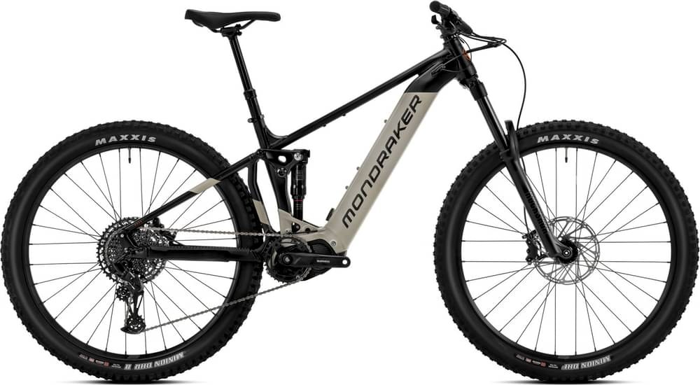

The 2023 Mondraker Dusk is a 29in aluminium full-power trail eMTB built on Mondraker's e-Bike Optimised Zero Suspension System, pairing 160mm up front with 150mm at the rear and the brand's long, low Forward Geometry. With a slack 65.5 degree head angle, 76 degree seat angle and reach stretching from 450mm on the SM to 510mm on the XL, it is squarely aimed at long days in the saddle and big-mountain singletrack rather than playful trail antics.
The base Dusk runs Shimano's then-new EP600 (EP6) motor, a 720Wh Simplo internal battery extendable to 1080Wh with the optional 360Wh range extender, plus a RockShox 35 Silver fork, Deluxe Select shock, SRAM SX Eagle 1x12 and SRAM DB8 four-piston brakes. The step-up Dusk R adds the more powerful Shimano EP801 motor, a Fox 36 Rhythm fork, Fox Float DPS shock, Mavic E-Deemax wheels and a SRAM GX Eagle mech. Both keep the same 85Nm peak torque and the same alloy frame and geometry.
This generation has since been discontinued. Mondraker has moved its full-power Shimano trail eMTB line forward, while the lightweight TQ-powered Neat sits alongside it as the SL option. As a heavier full-fat alloy eMTB with sorted geometry and a big usable battery, the Dusk remains a capable all-day adventure machine on the used market.
