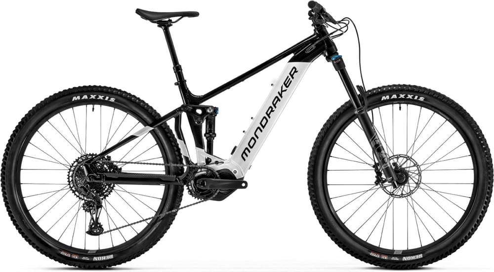

The 2022 Mondraker Dusk is the Shimano-powered sibling of the Crafty, built on the same 6061 alloy Stealth Evo frame with Mondraker's Zero Suspension System giving 150mm at the rear behind a 160mm fork on 29in wheels. Where the Crafty runs Bosch, the Dusk leans on the Shimano STEPS EP8 (DU-EP800) motor at 85Nm, fed by an internal, non-removable Simplo 630Wh battery with an optional external range extender for longer days out.
The three trims form a straightforward fork-and-shock ladder rather than a wholesale spec change. The base Dusk gets a RockShox 35 Silver fork and Deluxe Select shock with a SRAM SX Eagle drivetrain, the Dusk R steps up to a Fox 36 Rhythm and NX Eagle, and the top Dusk RR runs a Fox 36 Factory Kashima fork, GX Eagle, SRAM Code brakes and DT Swiss wheels. All three share the alloy frame, EP8 motor and 630Wh battery, so the differences are chassis quality and stopping power, not drivetrain philosophy.
This was a sensibly priced full-power trail eMTB for its era, undercutting the carbon Crafty while keeping the same geometry and suspension platform. It has since been discontinued as Mondraker's e-bike range moved on, so it is now a used-market proposition. Just remember the battery is integrated rather than removable, which matters for anyone who charges away from the bike.
