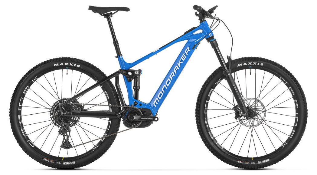

The 2024 Mondraker Chaser is an aluminium all-mountain eMTB built around the Bosch Performance Line CX (Gen 4, Smart System) motor with up to 85Nm and an internal Bosch PowerTube battery, in a 6061 Stealth Evo frame using Mondraker's Zero Suspension System and signature Forward Geometry. All sizes share a slack 65.5 degree head angle, a steep 76 degree effective seat angle, long 455mm chainstays and notably long reach for the size (450mm on the S rising to 510mm on the XL), spread across four sizes from S to XL on full 29in wheels.
The range splits into a genuine trail build and two crossover builds. The Chaser R is the pick for off-road riding: 160mm Fox 36 Rhythm fork, 150mm of rear travel through a Fox Float EVOL Performance shock, a 750Wh battery, Mavic E-Deemax wheels, Maxxis Rekon 2.6 tyres, SRAM GX Eagle and an Onoff Pija dropper, with a claimed 24.9kg. The Chaser RX (140mm rear, RockShox 35 Silver fork, 750Wh, Kiox 500 display) and Chaser X (140mm rear, RockShox Recon fork, 625Wh removable battery, rigid Onoff seatpost) are urban-cross oriented, shipping with lights, mudguards, a rear rack and a kickstand and rolling on faster Maxxis Ikon 2.6 tyres, both at a claimed 26.5kg.
This was a 2024 model and is now discontinued, so it is found at heavy clearance discounts. Mondraker's recommended retail prices were around 5,999 euros for the Chaser R and RX and 4,999 euros for the Chaser X; UK pricing was thinner, with the RX listed at an RRP of 5,220 pounds. Note that the brakes are SRAM DB8 four-piston with 200mm rotors front and rear across every trim, and the all-alloy frame keeps weights on the heavier side for the category.

Bosch Performance Line CX Gen 4 and a steep 76° seat angle keep the weight planted over the front — a proper winch. 600W of peak power and 85Nm of torque — a strong full-power motor.
Best suited toBig-day all-rounders who climb a lot and still descend hard.
Strong up and composed down — a do-it-all, not a specialist.
Watch out forNot a flickable, playful bike at 24.9kg — built to plough, not pop.
Brilliant on fast, rough, steep terrain; less fun on tight, mellow trails.

⚙️ Adjustable geometry: this frame has a high/low setting — low drops the BB and slackens the head angle for more descending stability; high lifts the BB and steepens slightly for clearance and a perkier, more playful feel.

SMLXL
Reach450 mm470 mm490 mm510 mm
Stack622 mm622 mm640 mm640 mm
Seattube380 mm420 mm450 mm490 mm
Chainstay455 mm455 mm455 mm455 mm
Headtube Angle65.5°65.5°65.5°65.5°
Seattube Angle (eff)76°76°76°76°
Wheelbase1225 mm1245 mm1265 mm1285 mm
Headtube110 mm110 mm130 mm130 mm
BB Height350 mm350 mm350 mm350 mm
Front Centre770 mm*790 mm*810 mm*830 mm*
FC:RC1.691.741.781.82
