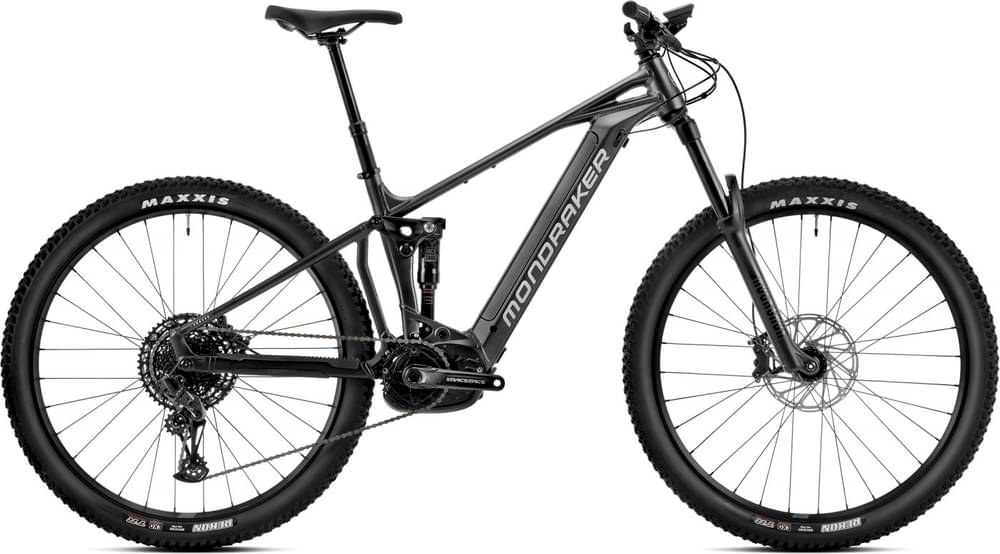

Geometry read
Size
Descending
58
A solid all-round descender (65.5° head angle, 150mm) — capable in the rough and steep without being an all-out bruiser.
Playfulness
30
More planted than poppy — better on steep terrain than tight, fiddly singletrack.
Size balance
98
Rear-long with a planted front in L (FC:RC 1.78) — easy to weight the front and quick to turn, though it can feel light at the back at real speed.
Technical climbing
75
Bosch Performance Line CX Gen 4 and a steep 76° seat angle keep the weight planted over the front — a proper winch. 600W of peak power and 85Nm of torque — a strong full-power motor.
Best suited toBig-day all-rounders who climb a lot and still descend hard.
Strong up and composed down — a do-it-all, not a specialist.
Watch out forNot a flickable, playful bike at 24.7kg — built to plough, not pop.
Brilliant on fast, rough, steep terrain; less fun on tight, mellow trails.
