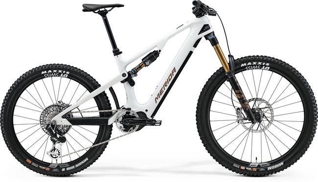

Merida eONE-SIXTY 2024
From £6,000
EMTB Forums verdict
The 2024 Merida eONE-SIXTY is the brand's full-power carbon enduro flagship, built on the CF4 III chassis with 170 mm up front and 174 mm at the rear. It pairs Shimano's EP801 drive unit with an integrated 600 Wh Trendpower battery and an optional 360 Wh range extender, so you can run it light or long. Merida's flexstay FAST kinematic and AGILOMETER reach-based sizing (XShort to XLong) carry straight over from the analogue ONE-SIXTY.
Geometry is firmly modern enduro: a 64.4 degree head angle across every size, seat angles around 78.3 to 78.5 degrees, a consistent 446 mm chainstay and reach stepping from 419 mm to 499 mm. A flip chip lets you swap the standard MX (29in front, 27.5in rear) setup for full 29in without upsetting the numbers, and the 30 to 230 mm travel-adjustable dropper effectively lets you tune frame feel between agile and stable.
The three carbon builds span a wide spread. The 10K goes all-in with Fox 38 Factory, Float X2 Factory and SRAM XX Transmission for 22.2 kg and a 10,500 pound price. The 7000 takes a hard-wearing Fox Performance and Shimano XT LinkGlide route, while the 6000 is the value pick on RockShox Domain and SRAM NX. All three share the same frame, motor, battery and geometry, so the choice comes down to budget and spec rather than ride character.
