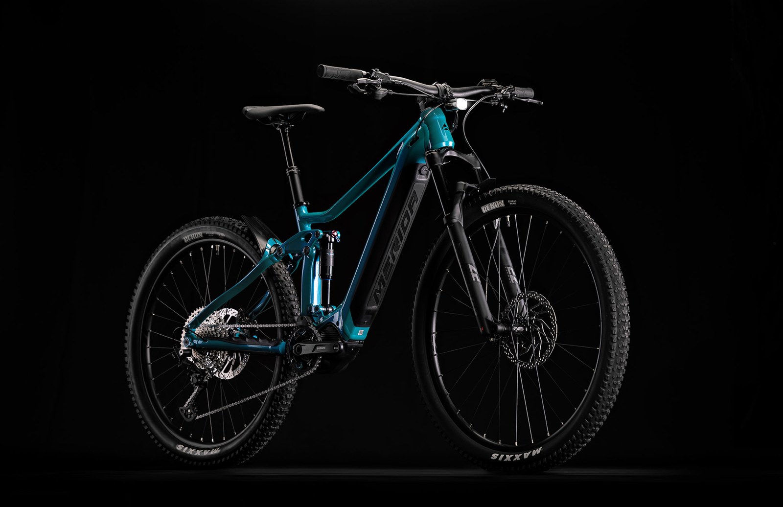

Merida eONE-FORTY 2022
From £4,650
EMTB Forums verdict
The 2022 Merida eONE-FORTY is the trail-focused little sibling of the eONE-SIXTY, built around a mixed-wheel 29er front / 27.5in rear platform with 140 mm of front and 133 mm of rear travel. Every trim runs Shimano's EP8 (85 Nm) motor. The core range used a 630 Wh integrated pack (500, 700, 8000 and the base EQ), while the 750 Wh builds (475, 575, 775 and 675 EQ) carried a Simplo internal battery for extra range. It is now discontinued, superseded by the later 630 Wh/750 Wh eONE-FORTY generations.
Geometry is consistent across all five sizes (S to XXL): a 66.5 degree head angle, 76.5 degree seat angle, 439.5 mm chainstays and a 25 mm bottom bracket drop, with reach spanning 410 mm (S) to 489 mm (XXL). That is a moderate, trail-oriented stance rather than an aggressive enduro number, matching Merida's Category 4 (AM + Enduro) billing.
Spec walks up cleanly. The 475/500/575 sit on Marzocchi/SR Suntour suspension with Shimano Deore 10/11-speed and M4100 brakes; the 700/775 step up to a Fox Rhythm 34 fork, RockShox Deluxe Select+ shock, Shimano XT 12-speed and SLX brakes. The range-topping carbon-front 8000 pairs a Fox Rhythm 34 with a Fox Performance Float DPS shock and Shimano's LinkGlide (XT M8130) drivetrain plus Continental Trail King tyres. The EQ variants add mudguards, rack, lights and a kickstand for commuting duty.
UK RRPs at launch were confirmed for the 500 (GBP 4,650) and 700 (GBP 5,650); the remaining trims were not offered with a GBP price on Merida's UK archive. No owner ride data is included here.
