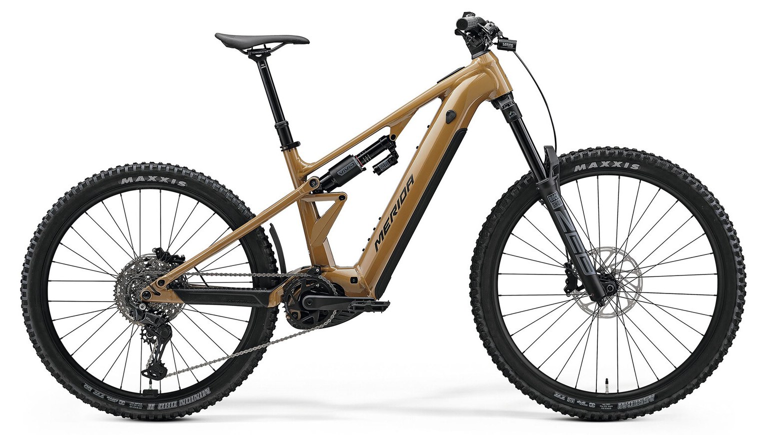

eONE-EIGHTY 2026
2026 carryover of the 180/180 enduro flagship
The Merida eONE-EIGHTY 2026 is the brand's full-power aluminium enduro flagship, carrying over for 2026 with Bosch's latest Performance Line CX Gen 5 power. Headline numbers: 180mm fork, 180mm rear, Bosch CX Gen 5 at 120Nm and 750W peak with a 2.8kg motor mass, an 800Wh battery, 64.5 degree head angle and reach 415 to 505mm across XShort to XLong. With no curated community quotes on file yet, this verdict draws on the gold spec and the well-known Bosch CX Gen 5 ecosystem behaviour. The eONE-EIGHTY is positioned as Merida's purest descent-focused tool, sitting above the trail-leaning eONE-SIXTY and eONE-FORTY in the lineup.
Drive system and range. The Bosch Performance Line CX Gen 5 is the headline. Following Bosch's PU2.0 firmware push, the legacy 85Nm Gen 4 has been retired and Gen 5 sits at 120Nm of torque and 750W peak with a refined dynamic mode that ramps assist more naturally than its predecessor. The 800Wh battery is generous and sensible for a 180/180mm rig: real-world range will sit at two to three and a half hours of mixed alpine descending in eMTB/Turbo, with 1,500 to 2,200m of vertical achievable for typical riders depending on weight and mode discipline. Battery removability is not specified in the gold spec; Merida's recent eONE platforms have offered removable PowerTube batteries, but buyers should confirm with their dealer. Bosch's Flow app, Kiox 300 display and OTA firmware updates come as standard.
Geometry and handling. 64.5 degrees up front is properly slack for the enduro brief. Reach steps are healthy and unusually wide for the segment: 415 (XShort), 435 (Short), 460 (Mid), 485 (Long), 505 (XLong): five genuine sizes is one of the broadest sizing strategies on a 180mm-class eMTB. Chainstays are a uniform 435mm, very short for a long-travel bike, which keeps the eONE-EIGHTY snappy in cornering and on switchbacks. Wheelbase tops out at 1294mm on XLong. The short rear paired with 180mm travel gives the bike a more playful character than longer-rear rivals like the Specialized Kenevo or YT Decoy.
Build and value. The gold spec lists a single base trim for 2026. Merida traditionally builds the eONE-EIGHTY in three or four trims with Fox or RockShox suspension, Shimano XT/SLX drivetrain and four-piston brakes; specific build sheets are confirmed at dealer level. The aluminium frame keeps entry pricing competitive versus carbon-only rivals. Standout: 5 sizes plus Bosch Gen 5 plus 800Wh on a 180/180mm aluminium platform is a strong value combination. Questionable: aluminium-only at this price tier; carbon enduro rivals are increasingly common at sub-EUR 7,000.
Caveats and known gripes.
- Aluminium only. No carbon frame option from Merida on the eONE-EIGHTY platform as of 2026; rivals like Specialized Kenevo and YT Decoy offer carbon at competitive price points.
- Battery removability not specified. Confirm at point of sale: integrated batteries impact storage and travel logistics.
- No curated community signal. The eONE-EIGHTY 2026 has limited owner reporting on the eMTB Forums community at the point of writing; long-term motor and frame reliability data for the latest carryover is yet to mature.
- 180/180mm travel. Full-bore enduro travel is more bike than most UK trail riders need; this is a tool for serious descending, not a do-everything trail platform.
- System weight. Not listed in gold spec, but Bosch CX Gen 5 with 800Wh on aluminium typically lands in the 25 to 27kg range: meaningfully heavier than carbon Avinox-powered enduro rivals.
- Build kit clarity. Single trim listed but Merida historically offers multiple builds; confirm trim spec with local dealer.
Verdict. The 2026 eONE-EIGHTY is one of the most credible aluminium enduro eMTBs on sale, with proper 180/180mm travel, modern slack geometry, the new Bosch CX Gen 5 motor and an 800Wh battery on a well-sized five-size platform. It suits riders who want full-bore enduro travel, who value Bosch's mature ecosystem and reliable dealer network, and who can live with an aluminium frame. Buyers chasing carbon frames, the lightest possible big-travel bike, or sub-21kg system weight should look at carbon-framed Avinox rivals or the Specialized Kenevo carbon variants. Production status: current (2026 carryover).
