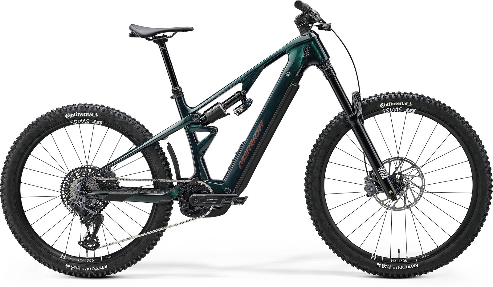

EMTB Forums verdict
The Lithos is Merida's all-new full-power enduro eMTB, built around a full carbon CF3 frame with 174mm rear and 170mm front travel on a mixed-wheel setup. Rather than chase headline weight or peak power, Merida prioritised durability and reliability, choosing Bosch's 120Nm / 750W Performance Line CX over the more powerful Avinox alternative, and backing the frame with a lifetime warranty for the original owner.
The flex-pivot, yoke-free suspension layout uses fewer bearings and is designed to reduce shock wear, while a flip chip lets you swap the stock MX setup to full 29" (dropping rear travel to 160mm). The removable battery comes in 600Wh or 800Wh forms, and Merida pairs the bike with its own travel-adjustable dropper and AGILOMETER sizing across five frame sizes.
Five builds span from the Shimano CUES-equipped 4000 up to the flagship 10K with Fox Podium and DHX Live Valve Neo. The £8,500 Lithos 8000 sits in the sweet spot with RockShox Zeb Ultimate, Vivid Ultimate, SRAM GX Eagle AXS Transmission and DT Swiss HX1700 wheels. Geometry is stable and modern at 64 degree head angle, 78.5 degree seat angle and a long 447mm chainstay across all sizes.

⚙️ Adjustable geometry: this frame has a high/low setting — low drops the BB and slackens the head angle for more descending stability; high lifts the BB and steepens slightly for clearance and a perkier, more playful feel.
Bike geometry diagram
XShortShortMidLongXLong
Reach425 mm440 mm460 mm485 mm510 mm
Stack628 mm637 mm646 mm655 mm669 mm
Seattube400 mm410 mm425 mm445 mm465 mm
Chainstay447 mm447 mm447 mm447 mm447 mm
Headtube Angle64°64°64°64°64°
Seattube Angle (eff)78.5°78.5°78.5°78.5°78.5°
Wheelbase1216 mm1235 mm1259 mm1289 mm1320 mm
Headtube100 mm110 mm120 mm130 mm145 mm
Standover757 mm762 mm762 mm765 mm769 mm
Front Centre769 mm*788 mm*812 mm*842 mm*873 mm*
FC:RC1.721.761.821.881.95
