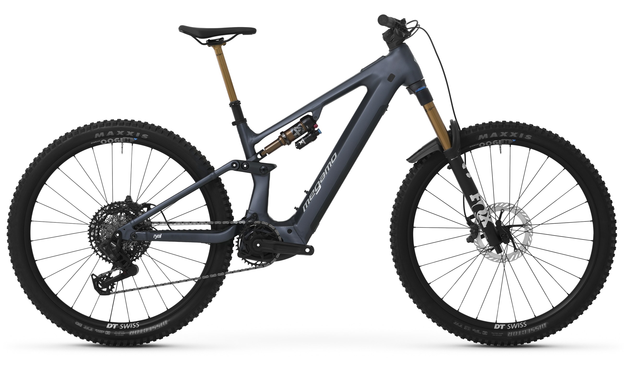

Megamo Ryal 2026
EMTB Forums verdict
The Ryal is Megamo's bid to make Avinox power affordable. It is a 160/160 mm alloy enduro e-MTB built around a removable 800 Wh battery and the Megamo ASP four-bar linkage, and it sits below the carbon Reason in the range with a deliberately more relaxed geometry: shorter reach, higher stack and longer 455 mm-plus chainstays for everyday composure rather than outright race aggression. A flip-chip offers High and Low positions, swinging the head angle between 63.7 and 63.5 degrees and dropping the BB from 351 to 348 mm.
Four alloy builds share the same frame, battery and travel. The 03 AXS is the halo bike with Fox 38 Factory and Float X Factory suspension, full SRAM S1000 Eagle AXS wireless shifting, DT Swiss H 1900 wheels and a Fox Transfer Factory dropper, all on the flagship Avinox M2S (150 Nm / 1500 W in Boost). The 05 keeps the M2S but steps to Fox 38 Performance, a Float Rhythm shock and mechanical SRAM 90 Eagle T-Type. The 08 and 10 move to the lighter Avinox M2 (125 Nm / 1100 W in Boost): the 08 pairs a RockShox Zeb with SRAM 70 Eagle and powerful Maven brakes, while the 10 is the EUR 3,999 entry point on a RockShox Psylo, Shimano XT mechanical shifting and a Deore cassette.
Worth noting for buyers: the 05, 08 and 10 are listed with a fixed Megamo Ø31.6 mm seatpost rather than a dropper, so only the 03 AXS ships with a dropper as standard. Brake rotor sizing is 203 mm front on the 03 AXS, 05 and 10, and 200 mm on the SRAM Maven-equipped 08.
This is a brand-new 2026 launch, so there is no long-term owner or reliability data yet. The headline value case is strong on paper, getting a removable-battery Avinox motor into an enduro chassis at prices well below most M2S rivals, but ride feel and durability remain unproven until bikes are in customers' hands.
