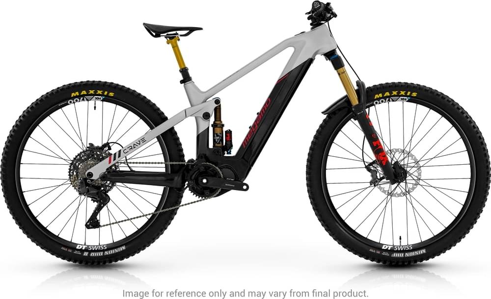

Megamo Crave CRB 2023
EMTB Forums verdict
The Megamo Crave CRB is the carbon-framed full-suspension all-mountain/enduro eMTB from Spanish brand Megamo, built on its Full Carbon FSC Technology frame with a carbon swingarm. For 2023 it ran a Shimano EP801 motor (85 Nm) fed by an integrated 762 Wh battery, with 160 mm of travel front and rear on 29in wheels. Geometry is shared across the whole range: a 65 degree head angle, 76 degree effective seat angle and 455 mm chainstays in every size (S/M/L), with reach growing 435 / 459 / 489 mm.
The 2023 line comprised five trims on that common frame, motor and battery, differing only on kit. The CRB 05 (5,549 EUR) used a 150 mm Fox 36 Rhythm fork, Fox Float DPS shock, mixed Shimano XT/Deore drivetrain and MT520 brakes. The CRB 03 (6,749 EUR) and CRB 02 (6,099 EUR) stepped up to a 160 mm Fox 38 Factory fork and Fox Float X shock with XT four-piston brakes, the 02 adding Shimano CUES AUTO Di2 electronic shifting and DT Swiss wheels. The flagship ALL-MTN (9,299 EUR) and ENDURO (9,649 EUR) paired the Fox 38 Factory with SRAM XX Eagle AXS T-Type wireless shifting and DT Swiss 1501 wheels, the ENDURO upgrading to a Fox Float X2 shock. All five roll on 29 x 2.6 Maxxis Minion DHF/DHR II tyres.
This is a discontinued 2023 model: the Crave CRB has been dropped from Megamo's current lineup and its product URL on megamo.com now returns a 404. Note that the CRB (carbon) badge distinguishes it from the alloy Crave AL, a separate frame. Pricing is given in euros from the Spanish manufacturer's per-trim spec sheets; no UK retailer RRP was found, so price_gbp is null (no FX conversion).

MotorShimano EP801 · 85 Nm · all trims
BatteryIntegrated 762Wh · 762 Wh · all trims
Travel F/R160/160 mm · all trims
FrameCarbon · all trims
ForkFox 38 Factory e-bike+, Kashima 29, 160mm, grip 2, 15QRx110, 44mm rakeFox 38 Factory e-bike+, Kashima 29, 160mm, grip 2, 15QRx110, 44mm rakeFOX 36 RHYTHM E-Bike, FLOAT 29, 150mm, Grip, Sweep-Adj, 15QRx110 Boost, 44mm RakeFox 38 Factory e-bike+, Kashima 29, 160mm, grip 2, 15QRx110, 44mm rakeFox 38 Factory e-bike+, Kashima 29, 160mm, grip 2, 15QRx110, 44mm rake
ShockFox FLOAT X, Factory Series, Kashima 2pos-adj, Trunnion, Evol LV, 205x65Fox FLOAT X, Factory Series, Kashima 2pos-adj, Trunnion, Evol LV, 205x65FOX Float DPS, Performance Series, 3pos, Trunnion, Evol LV, 205x65Fox FLOAT X, Factory Series, Kashima 2pos-adj, Trunnion, Evol LV, 205x65Fox Float X2, Factory Series, Kashima 2pos-adj, Trunnion, Evol LV, 205x65
HeadsetIntegrated, Full Internal Cable Routing · all trims
StemRace Face Aeffect3D Forged Alloy, Ext.: 60-70-90 mm, Rise: +/-7deg3D Forged Alloy, Ext.: 60-70-90 mm, Rise: +/-7degRace Face AeffectRace Face Aeffect
HandlebarRace Face Turbine RAlloy Butted 31,8x780 mm, Rise: 12 mm, Back Sweep: 6degAlloy Butted 31,8x780 mm, Rise: 12 mm, Back Sweep: 6degRace Face Turbine RRace Face Turbine R
SaddleSelle San Marco GrouND Short Open-fit TitaniumSelle Italia Model XSelle Italia Model XSelle San Marco GrouND Short Open-fit TitaniumSelle San Marco GrouND Short Open-fit Titanium
SeatpostFox Transfer Kashima 31,6mm telescopic seat post, remote adjustmentFox Transfer Kashima 31,6mm telescopic seat post, remote adjustmentMegamo 31,6mm telescopic seat post, remote adjustmentFox Transfer Kashima 31,6mm telescopic seat post, remote adjustmentFox Transfer Kashima 31,6mm telescopic seat post, remote adjustment
BrakesShimano XT M8020 Hydraulic disc 4-Piston, 203mmShimano XT M8020 Hydraulic disc 4-Piston, 203mmShimano MT520 hydraulic disc 4-Piston, 203mmShimano XT M8020 Hydraulic disc 4-Piston, 203mmShimano XT M8020 Hydraulic disc 4-Piston, 203mm
Rear derailleurShimano CUES AUTO Di2 11sShimano XT 12sShimano XT 12sSRAM XX Eagle AXS T-Type 12sSRAM XX Eagle AXS T-Type 12s
CrankShimano 36tShimano 36tShimano 36tSRAM E-Bike 36tSRAM E-Bike 36t
ShiftersShimano CUES AUTO Di2 11sShimano Deore 12sShimano Deore 12sSRAM XX Eagle AXS 12sSRAM XX Eagle AXS 12s
CassetteShimano CUES AUTO Di2 11sShimano Deore 12s 10-51tShimano Deore 12s 10-51tSRAM XX Eagle AXS T-Type 10-52 12sSRAM XX Eagle AXS T-Type 10-52 12s
DrivetrainShimano CUES AUTO Di2 11s; Shimano 36t; Shimano CUES AUTO Di2 11s; Shimano CUES AUTO Di2 11sShimano XT 12s; Shimano 36t; Shimano Deore 12s; Shimano Deore 12s 10-51tShimano XT 12s; Shimano 36t; Shimano Deore 12s; Shimano Deore 12s 10-51tSRAM XX Eagle AXS T-Type 12s; SRAM E-Bike 36t; SRAM XX Eagle AXS 12s; SRAM XX Eagle AXS T-Type 10-52 12sSRAM XX Eagle AXS T-Type 12s; SRAM E-Bike 36t; SRAM XX Eagle AXS 12s; SRAM XX Eagle AXS T-Type 10-52 12s
WheelsDT Swiss 1700 HX 30 - Mspline29 Asymmetric 15x110 12x148 Boost Wide:30mm Tubeless Ready29 Asymmetric 15x110 12x148 Boost Wide:30mm Tubeless ReadyDT Swiss 1501 HXC 30DT Swiss 1501 HXC 30 - XD
TyresFront: 29x2,6 Maxxis Minion DHF, Rear: 29x2,6 Maxxis Minion DHR II, Tubeless Ready, EXO Protection / Pirelli Scorpion Enduro S HardWALL · all trims
