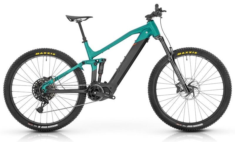

Megamo Crave AL 2024
EMTB Forums verdict
The Megamo Crave AL 2024 is the aluminium-framed version of the Spanish brand's trail and all-mountain eMTB. The shared chassis is built around a Horst Link 4-bar layout with 160 mm of frame travel up front (150 mm at the rear) and a fully integrated battery, running 29in wheels with generous 2.6in Maxxis Minion DHF/DHR II rubber. Geometry is consistent across the range, with a 64.3-degree head angle, 73-degree seat angle and 451 mm chainstays in every size.
Most trims use a Shimano EP801 motor (85 Nm) paired with a sizeable 762 Wh battery, so range was never the limiting factor. The line spans a wide spread: the AL 10 at 4,999 EUR runs a RockShox 35 Silver fork and SRAM SX Eagle, the AL 05 steps up to Fox 36 Rhythm and Shimano Deore, the AL 03 adds a Fox 38 Factory and Shimano XT, and the range-topping Gravity at 7,149 EUR pairs the Fox 38 with a coil Fox Float DHX2 shock and Race Face cockpit. The cheaper AL 40 is a different proposition, dropping to a Shimano EP6 motor, a 630 Wh battery, a 130 mm Suntour fork and a 10-speed Shimano CUES build.
Megamo has limited UK retail presence, so pricing here is quoted in euros from the manufacturer's own catalogue. This is a discontinued 2024 model, superseded by the 2025 Crave AL, which simplified the line to the AL 40 and AL 10 trims.

How it stacks up vs other Full Power · Trail bikes (from 223 bikes in the database)
Battery762 Wh55 Wh above average
Motor torque85 Nm13 Nm below average
Bike geometry diagram
SML
Reach455 mm470 mm490 mm
Stack627 mm632 mm636 mm
Seattube410 mm460 mm510 mm
Chainstay451 mm451 mm451 mm
Headtube Angle64.3°64.3°64.3°
Seattube Angle (eff)73°73°73°
Wheelbase1246 mm1263 mm1285 mm
Headtube135 mm140 mm145 mm
BB Height361 mm361 mm361 mm
Front Centre795 mm*812 mm*834 mm*
FC:RC1.761.801.85
