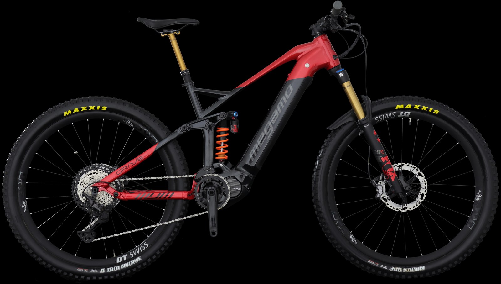

Megamo Crave AL 2022
EMTB Forums verdict
The Megamo Crave AL 2022 is the aluminium-framed version of the Spanish brand's full-suspension trail and all-mountain eMTB, with the carbon Crave CRB as its sibling. The chassis uses a Horst Link 4-bar layout, a triple-butted alloy frame with a fully integrated battery and 29in wheels running roomy 2.6in Maxxis Minion rubber. Megamo quotes 150 mm of rear travel matched to a 160 mm fork on most trims. Geometry is shared across the whole range, with a 65.3-degree head angle, a 75-degree effective seat angle, 465 mm chainstays and reach growing from 431 mm on the S to 474 mm on the L.
Every 2022 build carries an integrated 630 Wh battery, but the motor changes as you move down the line. The Gravity, AL 03 and AL 05 use the Shimano EP8 (85 Nm), the AL 10 runs the newer Shimano EP801 (85 Nm), and the entry AL 40 steps down to the Shimano EP6 mid-power unit. The Gravity tops the range at 7,599 euros with a Fox 38 Factory fork, a coil Fox Float DHX2 shock, Shimano XT gearing and DT Swiss wheels. The AL 03 (6,499 euros) keeps the Fox 38 but swaps to an air Fox DPX2 shock, the AL 05 (5,399 euros) drops to a 150 mm Fox 34 Rhythm and Shimano Deore, the AL 10 (4,289 euros) moves to a RockShox 35 Silver fork and SRAM SX Eagle, and the AL 40 EP6 (4,449 euros) pairs a 130 mm Suntour XCR 34 fork with a 10-speed Shimano Deore drivetrain.
Megamo has limited UK retail presence, so pricing here is quoted in euros from the manufacturer's own 2022 catalogue rather than a British RRP. This is a discontinued 2022 model; later Crave AL generations moved to a larger 762 Wh battery and standardised on the Shimano EP801 motor. No independent owner ride or reliability data is included here.
