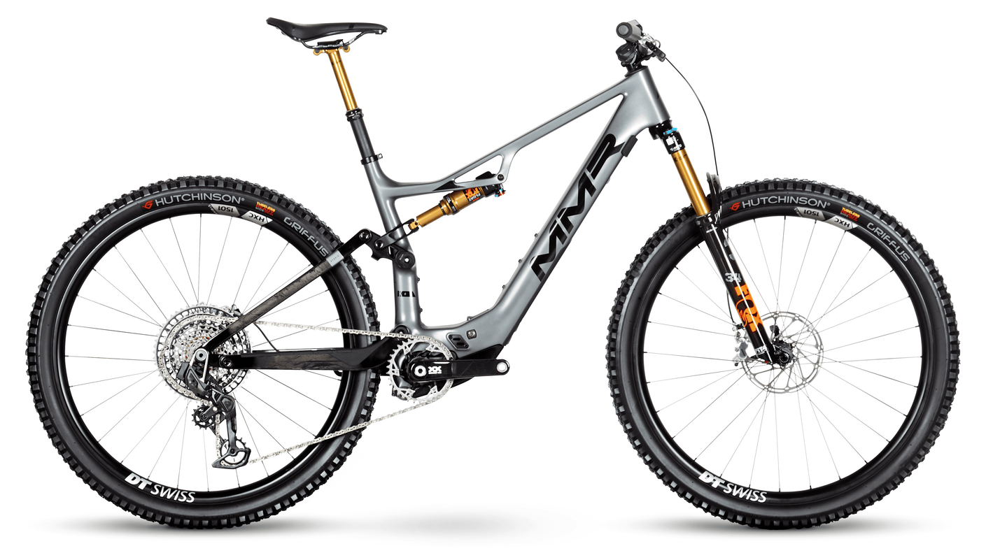

The MMR Kaizen 2025 is the Spanish brand's lightweight trail eMTB: a carbon chassis with 140 mm of fork travel paired with 130 mm of rear, powered by Bosch's Performance Line SX motor at 55 Nm torque and a 600 W peak. With a ~17 kg headline weight and a 400 Wh battery, the Kaizen is firmly in the lightweight category and squares up against bikes like the Specialized Levo SL Gen 2, Orbea Rise H and Trek Fuel EXe. At €4,999 for the base trim it is one of the more aggressively priced Bosch SX builds on sale.
Drive system and range. The Bosch Performance Line SX is Bosch's lightweight motor unit: 55 Nm of torque, 250 W rated, 600 W peak and a 2.0 kg unit weight. Following the July 2025 firmware update Bosch raised SX peak power to 600 W and improved the assist character; the post-update SX is significantly more capable than its launch firmware. The 400 Wh battery is integrated and offers a real-world range of around 800–1,200 m of climbing in mixed riding, with a Bosch range extender option for big-day capability. The Bosch SX is supported by the full Smart System ecosystem: eBike Flow app, OTA updates, the Kiox or Mini Remote display options.
Geometry and handling. A 66.0 degree head angle is firmly in the modern trail rather than enduro bracket — appropriate for a 140/130 mm travel lightweight platform. Reach progresses from 420 mm (S) through 450 mm (M) to 491 mm (L) — sensible. The 455 mm chainstay is held constant across sizes and is on the longer side for a 140 mm trail bike, prioritising climbing traction and stability over the most playful possible feel. Wheelbase grows from 1,180 mm to 1,266 mm. Three sizes is the main fit caveat — riders below 5'4" or above 6'2" should check carefully.
Build and value. Only the €4,999 base trim is gold-listed. At that price for a Bosch SX-equipped carbon lightweight platform, the Kaizen sits between mainstream value (Cube AMS Hybrid SX builds at €3,500–€4,200) and boutique premium (Pivot Shuttle SL at €8,000+). MMR's reputation in road and gravel categories is solid; the Kaizen is part of the brand's growing eMTB presence.
Caveats and known gripes. No curated forum quotes or excerpts exist for the Kaizen — first-hand owner data is essentially absent. MMR's UK dealer presence is essentially nil (their domestic strength is Spain and Italy), so warranty and service pathways need clarifying before purchase. The 400 Wh battery is integrated (non-removable on most SX builds) and limits big-day range without the optional extender. The 55 Nm motor is the entry-level Bosch unit — riders expecting trail-class punch will find it more modest than EP801 or CX Gen 5 alternatives. The 66 degree head angle and 455 mm constant chainstay are conservative for the 17 kg lightweight class where bikes like the Levo SL Gen 2 now run 64.5–65 degrees and shorter stays for a more playful feel.
Verdict. The MMR Kaizen is a competent lightweight trail eMTB at a competitive Spanish-direct price: a sub-17 kg carbon platform with the Bosch SX drive system and Smart System ecosystem support for €4,999. It will suit riders who want the lightweight ride feel and natural pedal character of an SL-class eMTB and value the Bosch ecosystem over more boutique alternatives, and who are happy to deal with a brand that has limited UK retail presence. Buyers who want more aggressive trail geometry, longer travel, removable batteries or first-hand community ownership data should look at the Specialized Levo SL Gen 2 or Orbea Rise H. Production status: current.
