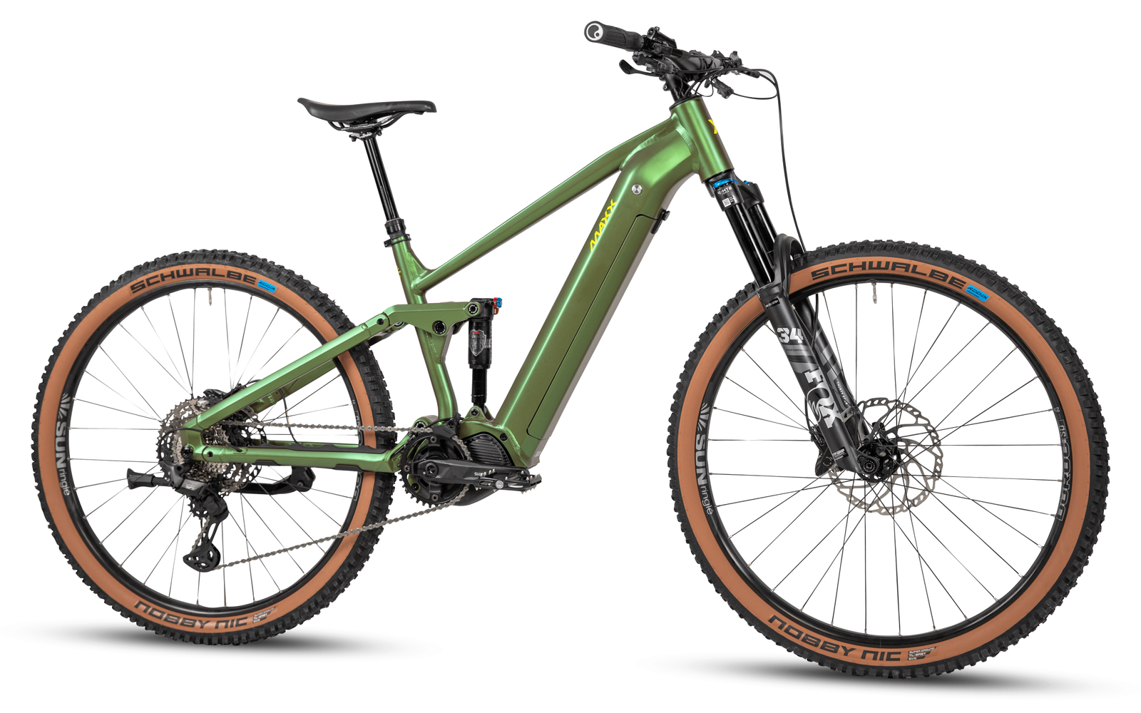

MAXX Tourmaxx ELS Sport 2023
Geometry read
Size
Descending
51
A solid all-round descender (66.5° head angle, 130mm) — capable in the rough and steep without being an all-out bruiser.
Playfulness
38
More planted than poppy — better on steep terrain than tight, fiddly singletrack.
Size balance
78
Rear-long with a planted front in L (FC:RC 1.68) — easy to weight the front and quick to turn, though it can feel light at the back at real speed.
Technical climbing
75
Shimano EP8 (DU-EP800) and a steep 75° seat angle keep the weight planted over the front — a proper winch. 500W of peak power and 85Nm of torque — a strong full-power motor.
Watch out forNot a flickable, playful bike — built to plough, not pop.
Brilliant on fast, rough, steep terrain; less fun on tight, mellow trails.

Bike geometry diagram
SMLXLXXL
Reach427 mm447 mm465 mm483 mm501 mm
Stack633 mm642 mm653 mm665 mm679 mm
Seattube380 mm420 mm470 mm520 mm560 mm
Chainstay470 mm470 mm470 mm470 mm470 mm
Headtube Angle66.5°66.5°66.5°66.5°66.5°
Seattube Angle (eff)75°75°75°75°75°
Wheelbase1214 mm1237 mm1260 mm1283 mm1307 mm
Headtube125 mm135 mm145 mm160 mm175 mm
BB Height345 mm345 mm345 mm345 mm345 mm
Front Centre744 mm*767 mm*790 mm*813 mm*837 mm*
FC:RC1.581.631.681.731.78
Trims · 1
Base
£0
MotorShimano EP8 (DU-EP800) · 85 Nm
BatteryShimano in-tube 726 Wh · 726 Wh
Travel F/R130/130 mm
FrameAluminium (6061-T6 MAXX Custom tubing, Octatube)
ForkSunTour Mobie E35, 130mm, 29", TA 15x110, air, with lockout, black
ShockFox Float DPS TR 185x55, adjustable platform, air
HeadsetAcros AZA-638 R4, semi-integrated alloy cartridge, tapered
StemMAXX MTB 0° or 7°
HandlebarMAXX Rizer 35 MTB
GripsRace Grip screw-on lock-on, 130mm, black
SaddleSelle Italia Man Flow
SeatpostMAXX Premium with quick-release
BrakesMagura MT5 Trail Sport, 4/2-piston disc, 203/180mm
Rear derailleurShimano XT RD-M8130 (LinkGlide, 11-speed)
CrankShimano SM-CRME80, 34T
ShiftersShimano XT SL-M8130 (LinkGlide, 11-speed)
CassetteShimano CS-LG700 11-50T, 11-speed LinkGlide
ChainShimano CN-HG601, 11-speed
DrivetrainShimano XT RD-M8130 (LinkGlide, 11-speed); Shimano SM-CRME80, 34T; Shimano XT SL-M8130 (LinkGlide, 11-speed); Shimano CS-LG700 11-50T, 11-speed LinkGlide; Shimano CN-HG601, 11-speed
WheelsSun Ringle Duroc 30, 32H, black (front hub SunRingle SRC 15x110, rear hub SunRingle SRC Disc 6L 12x148)
TyresSchwalbe Nobby Nic Performance folding, 62-622 (29x2.4")
Price£0
