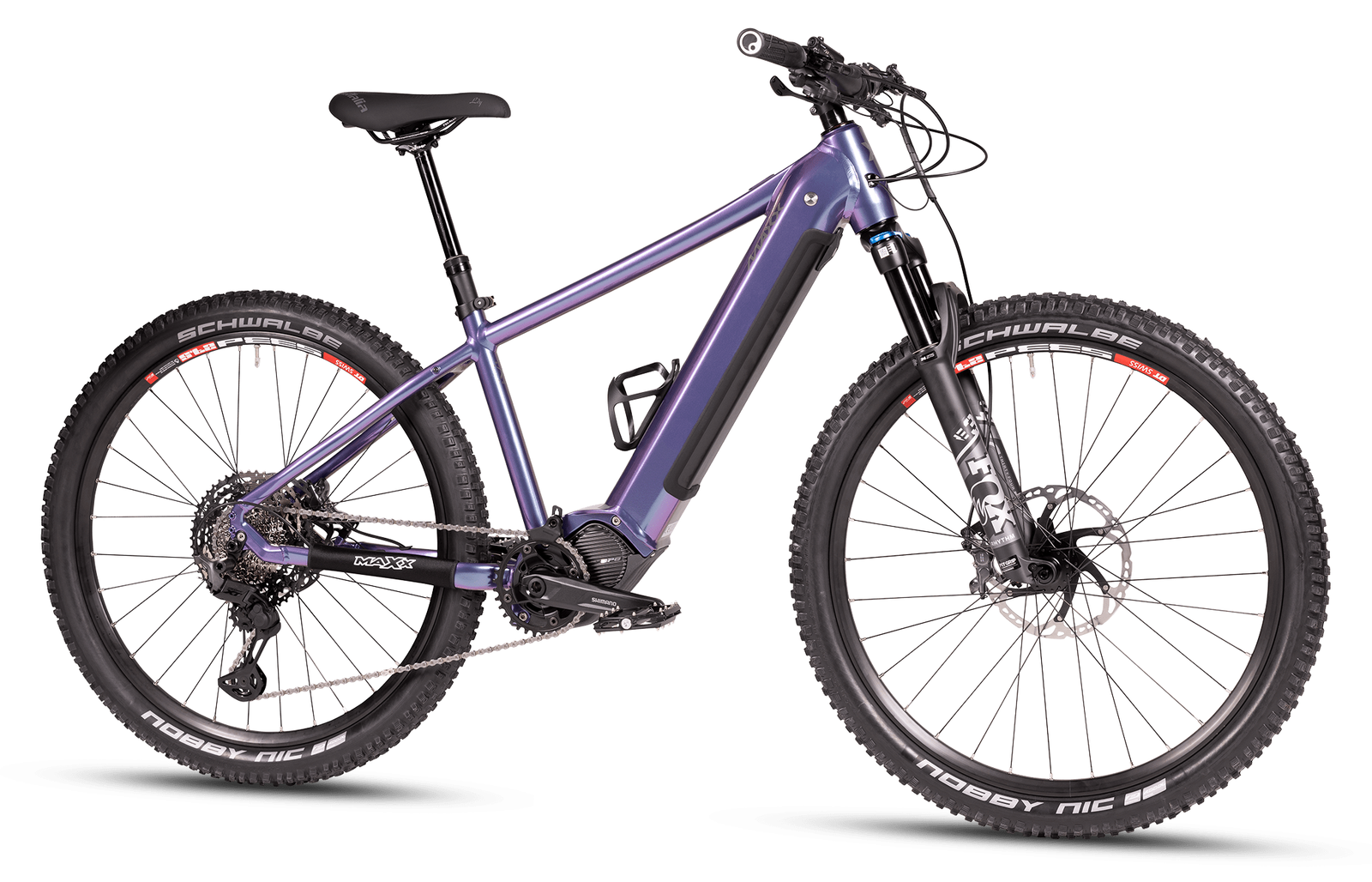

MAXX Racemaxx ELS 2022
EMTB Forums verdict
The MAXX Racemaxx ELS is the full-power hardtail in the boutique Bavarian brand's e-mountain bike line. It pairs a Shimano EP8 mid-motor (85Nm) with a fully integrated, removable 726Wh down-tube battery, and runs roughly 100 to 120mm of fork travel on a relaxed 68 degree head angle and 73 degree effective seat angle chassis. The rear is rigid, so this is a true e-hardtail.
The frame is welded from MAXX's own 6061-T6 aluminium custom tubing with the distinctive eight-sided Octatube down tube, a Boost 12x148mm rear axle, internally routed cables and a twin-layer powder coat. MAXX pitches it as a multitool: XS and S sizes roll on 27.5in wheels while M and up take 29in or optional B+ tyres up to 75mm wide, and the same chassis can be set up as a sporty trail e-MTB or, with the optional rack, mudguards and side stand, as a touring ATB. The size run is unusually broad, spanning frames from XS to 4XL for riders from about 1.50m to 2.12m.
As with every MAXX, this is built to order through the configurator, so the fork, brakes, drivetrain and tyres are specified per customer rather than sold as a fixed off-the-peg model. The 2022 page lists no branded component build, only the drive unit, frame and geometry. A reference example from a 2022 unit ran a Shimano XT 1x11 drivetrain, Magura MT Trail Sport brakes, an SR Suntour Raidon fork and Schwalbe Nobby Nic tyres, with a manufacturer recommended price of about 6,200 euros; because the bike is made to order there is no single fixed factory price.
This is a low-volume German hand-built bike with no meaningful pool of owner feedback, and it has since been superseded in the MAXX range, so it is now a discontinued model.

MotorShimano EP8 (DU-EP800) · 85 Nm
BatteryShimano down-tube 726Wh · 726 Wh
Travel F/R120/? mm
Frame6061-T6 aluminium, Octatube (8-sided down tube) MAXX Custom Tubing, twin-layer powder coat, internal cable routing, Boost 12x148mm rear axle, oversized tapered headset
ForkSuspension fork, 100-120mm travel on M and up (XS/S 80-100mm). The 2022 maxx.de page publishes no fork brand/model - the fork is a configurator selection. A dealer listing of an actual 2022 unit ran an SR Suntour Raidon fork.
HeadsetOversized tapered headset.
SeatpostDropper (Vario) seatpost on the sport build; configurator selection.
BrakesMagura MT Trail Sport hydraulic disc (from a 2022 dealer build; brand chosen via configurator).
Rear derailleurShimano XT (1x11 on a 2022 dealer build; drivetrain chosen via configurator).
DrivetrainShimano XT (1x11 on a 2022 dealer build; drivetrain chosen via configurator).
TyresSchwalbe Nobby Nic in the sport/MTB build; XS/S 27.5in, M and up 29in or optional B+ up to 75mm (3in). Tyre choice is a configurator selection.
