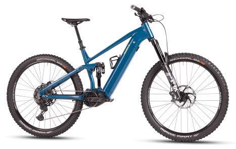

The MAXX FAB.4 ELS is the trail-focused full-power eMTB from the boutique Bavarian manufacturer MAXX. It pairs a Shimano EP8 motor (85Nm) with a removable 726Wh down-tube battery, and runs 150mm of travel front and rear on a sporty 66 degree head angle, 74.5 degree effective seat angle chassis.
The frame is welded from MAXX's own 6061-T6 aluminium custom tubing with the distinctive eight-sided Octatube down tube and an extra-wide motor mount, finished in your choice of colour with a twin-layer powder coat in gloss or matt. It rolls on 29in wheels (the smallest S size uses 27.5in), takes tyres up to 62mm wide and fits four sizes from S to XL covering riders from 1.60m to 1.96m.
As with all MAXX bikes this is built to order through the configurator, so equipment, ergonomics and finish are specified per customer rather than sold as fixed off-the-peg models. The published standard EP8 Pro build seen at dealers runs a Fox 36 fork, Fox Float DPX2 shock, Shimano XT four-piston brakes and a 150mm Fox Transfer dropper.
