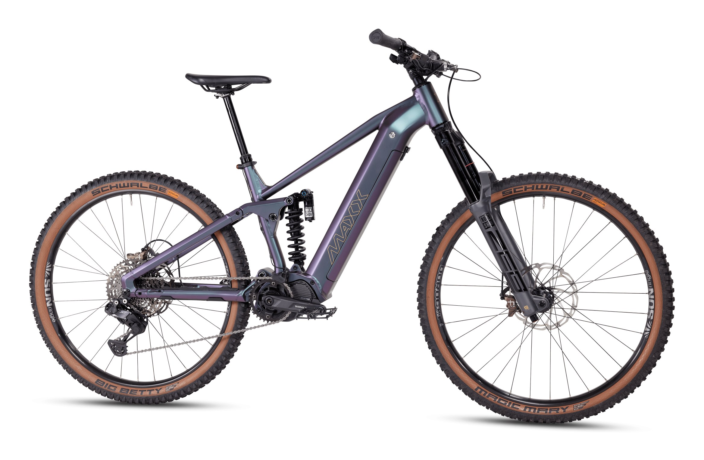

The MAXX FAB.4 ELS is the full-power, full-suspension enduro and all-mountain eMTB from the boutique Bavarian frame builder MAXX. In this 2022 archive capture it pairs a Shimano EP8 mid-motor (85Nm) with a fully integrated, removable 726Wh down-tube battery, and runs 150mm of travel front and rear on a sporty chassis with a 66 degree head angle and a 74.5 degree effective seat angle. The fork is fitted at 150 to 160mm as standard and can optionally be run at 160 or 170mm.
The frame is welded from MAXX's own 6061-T6 aluminium custom tubing with the distinctive eight-sided Octatube down tube and an extra-wide motor mount, twin-layer powder coated in your choice of colour. It uses a stiff Boost 12x148mm rear axle and offers 29in or B+ wheel options. The 2022 range spans five sizes from S to XXL, covering riders from 1.60m to 2.08m, with the smallest S size running 27.5in / B+ wheels and M to XXL running 29in / B+.
As with every MAXX bike this is built to order through the configurator, so equipment, ergonomics and finish are specified per customer rather than sold as fixed off-the-peg models. MAXX itself publishes only the frame data and fitting dimensions (fork travel, shock fitment, crank length, handlebar, stem, seatpost and tyre clearance) plus general bullets for the drive system, battery and Shimano controls. The dealer standard build seen with this frame runs a Fox 36 fork, Fox Float DPX2 shock, Shimano XT four-piston brakes and Schwalbe Nobby Nic tyres, with a sample build priced around 5,516 euros.
As a low-volume German hand-built bike there is no meaningful pool of owner feedback, and the FAB.4 ELS has since been superseded, so it is now a discontinued model.
