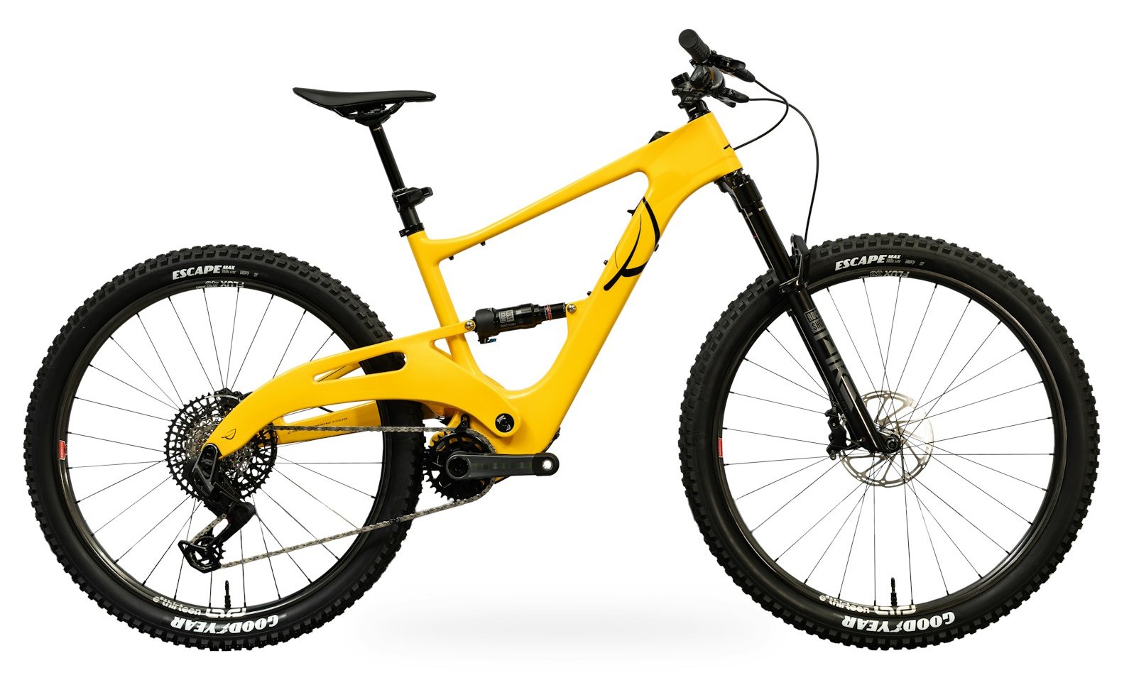

Lauf eElja 2026
EMTB Forums verdict
Lauf's first eMTB takes the brand's lightweight ethos straight to the trail. The eElja is built around the TQ HPR60 drive system (60Nm, 350W) and a carbon frame using Lauf's IRM layup, with claimed weights from 17.1kg for the Race build and 17.7kg for the alloy-wheeled Weekend Warrior. With 140mm up front and 130mm out back on a single-pivot LSP suspension layout, this sits firmly in the lightweight trail eMTB bracket rather than chasing outright power.
The battery story is the headline. A 360Wh internal pack is standard on the entry Weekend Warrior, while both Long Range builds add a 160Wh Range Extender for 520Wh total. That pairs a small, efficient motor with a modest base battery to keep weight down, leaning on range extension rather than a bigger fixed cell.
All three builds share the frame, motor, SRAM DB8 four-piston brakes on 180mm rotors, fully wireless SRAM AXS Transmission shifting and a RockShox Reverb AXS dropper, so trim choice comes down to suspension and wheels. The Weekend Warrior runs a RockShox Pike and Deluxe Select with GX Transmission and alloy DT Swiss wheels; the Long Range version adds the Range Extender for $500 more; the Race steps up to Select+ damping, X0 Transmission, e*thirteen carbon cranks and carbon Optimus wheels.
Geometry is consistent and trail-oriented across the range: a 65.1 degree head angle on every size, a 448mm chainstay throughout, and reach growing 416mm to 502mm from S to XL. Seat angles steepen on the smaller frames (76.8 degrees on S, easing to 75.3 degrees on XL), and 29x3.0in tyre clearance is unusually generous for the category.

MotorTQ HPR60 · 60 Nm · all trims
BatteryTQ 360Wh · 360 Wh · all trims
Travel F/R140/130 mm · all trims
FrameCarbon · all trims
ForkRockshox Pike Select+ 140mmRockshox Pike 140mmRockshox Pike 140mm
ShockRockShox Deluxe Select+, 190x45mm · all trims
HeadsetFSA Orbit, IS 42/52 (36° lower), damped Honey bearings · all trims
StemFSA Comet Φ35 (S:35mm, M-XL: 50mm) · all trims
HandlebarLauf Mtn Bar, 780mm wide, Ø35mm · all trims
GripsLauf bolt-on grips · all trims
SaddleFizik Vento Argo X5 140mm, OEM version · all trims
SeatpostRockShox Reverb AXS, Ø31.6mm · all trims
BrakesSRAM DB8 4-Piston · all trims
Rear derailleurSRAM Eagle Transmission X0, wireless shiftingSRAM Eagle Transmission GX, wireless shiftingSRAM Eagle Transmission GX, wireless shifting
Cranke*thirteen Helix Race E*Spec Carbon Crankset 32t, 160mm, 55CLe*thirteen Helix Core E*Spec Alloy Crankset 32t, 160mm, 55CLe*thirteen Helix Core E*Spec Alloy Crankset 32t, 160mm, 55CL
ShiftersSRAM AXS PODS, wireless shifting · all trims
CassetteSRAM XS-1275 Eagle Transmission Cassette, 12 speed, 10-52tSRAM XS-1275 Eagle Transmission, 12 speed, 10-52tSRAM XS-1275 Eagle Transmission, 12 speed, 10-52t
ChainSRAM Eagle Transmission GX, flat-top, 118 links · all trims
DrivetrainSRAM Eagle Transmission X0, wireless shifting; e*thirteen Helix Race E*Spec Carbon Crankset 32t, 160mm, 55CL; SRAM AXS PODS, wireless shifting; SRAM XS-1275 Eagle Transmission Cassette, 12 speed, 10-52t; SRAM Eagle Transmission GX, flat-top, 118 linksSRAM Eagle Transmission GX, wireless shifting; e*thirteen Helix Core E*Spec Alloy Crankset 32t, 160mm, 55CL; SRAM AXS PODS, wireless shifting; SRAM XS-1275 Eagle Transmission, 12 speed, 10-52t; SRAM Eagle Transmission GX, flat-top, 118 linksSRAM Eagle Transmission GX, wireless shifting; e*thirteen Helix Core E*Spec Alloy Crankset 32t, 160mm, 55CL; SRAM AXS PODS, wireless shifting; SRAM XS-1275 Eagle Transmission, 12 speed, 10-52t; SRAM Eagle Transmission GX, flat-top, 118 links
Wheelse*thirteen Optimus Carbon Sidekick, 29", 6-bolt, XD freehub, tubeless completeDT Swiss M1900 Spline, 29", alloy, 6-bolt, XD freehub, tubeless completeDT Swiss M1900 Spline, 29", alloy, 6-bolt, XD freehub, tubeless complete
TyresGoodyear Escape Max Trail Lite 2.6" 120tpi (Optional: Goodyear Peak 2.6") · all trims
Weight17.1 kg17.7 kg17.7 kg
