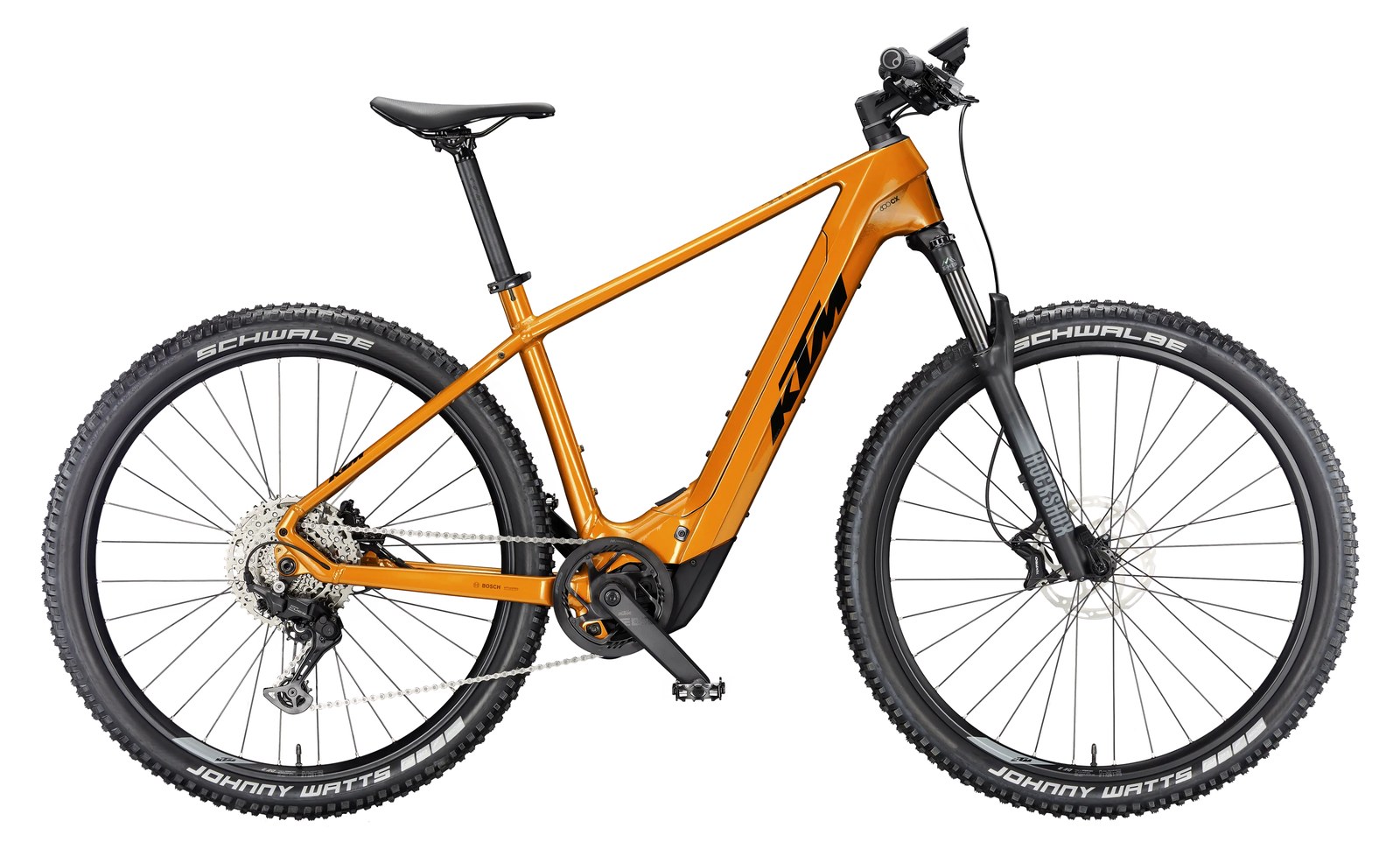

The Macina Team is KTM's sporty 29in hardtail e-mountain bike line, built around a stiff 6061 alloy UDH frame, a Bosch Performance Line CX motor (85 Nm, 600 W peak) and a sizeable 800 Wh PowerTube battery loaded through KTM's top-loader hatch. With 120 mm of fork travel and no rear suspension, it sits at the trail-capable end of the e-hardtail world rather than full enduro territory.
The geometry is conservative and upright by modern standards: a 68.5 to 69 degree head angle, 73 degree seat angle and a roomy stack relative to reach (618 to 636 mm stack against 401 to 430 mm reach across M to XL). Chainstays stay fixed at 460 mm and the bottom bracket sits at 314 mm, so this is a stable, comfort-oriented hardtail aimed at fitness and adventure riding more than aggressive descending.
Within the 2025 range the standard 892 at 3,999 euro covers the essentials with a RockShox Recon Silver fork, Shimano CUES 10-speed and Tektro four-piston brakes on a rigid post. The 891 at 5,199 euro is the pick for trail use, swapping in a FOX 34 fork, a TRP 12-speed drivetrain, Shimano Deore four-piston brakes and a dropper post for a meaningful step up in control. The cheaper 893 undercuts both at 3,699 euro for buyers prioritising the 800 Wh battery and Bosch CX motor over premium kit.
