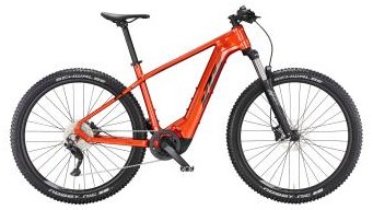

KTM Macina Team 2024
EMTB Forums verdict
The 2024 KTM Macina Team is the Austrian brand's sporty Bosch-powered MTB hardtail, not the full-suspension trail or enduro bike its name might suggest. The full-suspension KTM enduro line is the Macina Prowler; the Team sits below it as a fast, capable hardtail. Every 2024 Team shares the same Bosch Performance Line CX Gen 4 motor (85 Nm) and a sizeable, horizontally mounted 750Wh PowerTube battery, removed via KTM's own Power Tube Top Loader system.
The 29in models step up cleanly. The 793 is the value pick with a coil Suntour XCM 34 fork, two-piston Shimano MT200 brakes and a rigid post. The 792 adds a RockShox Recon air fork and four-piston Tektro stoppers. The flagship 791 is clearly the one to have, pairing a FOX 34 Float fork, Shimano Deore XT 11-speed, four-piston Deore brakes, grippy Maxxis Rekon rubber, a Kiox 300 display with Bosch GPS module and, crucially, a dropper post, all for a sub-25 kg claimed weight.
Geometry is conventional and friendly rather than aggressive, with a roughly 69 degree head angle, 73 degree seat angle and 474 mm chainstays across the M, L and XL sizes. That makes it a comfortable, planted trail and tour companion rather than an outright enduro weapon, which is fitting for a 120 mm hardtail.
Note this is a discontinued 2024 model, superseded by the 2025 Macina Team (trims 891/892/893), which moved to the newer Bosch hardware. Prices listed are native euro RRPs; no UK sterling RRP was published for the Team in 2024.
