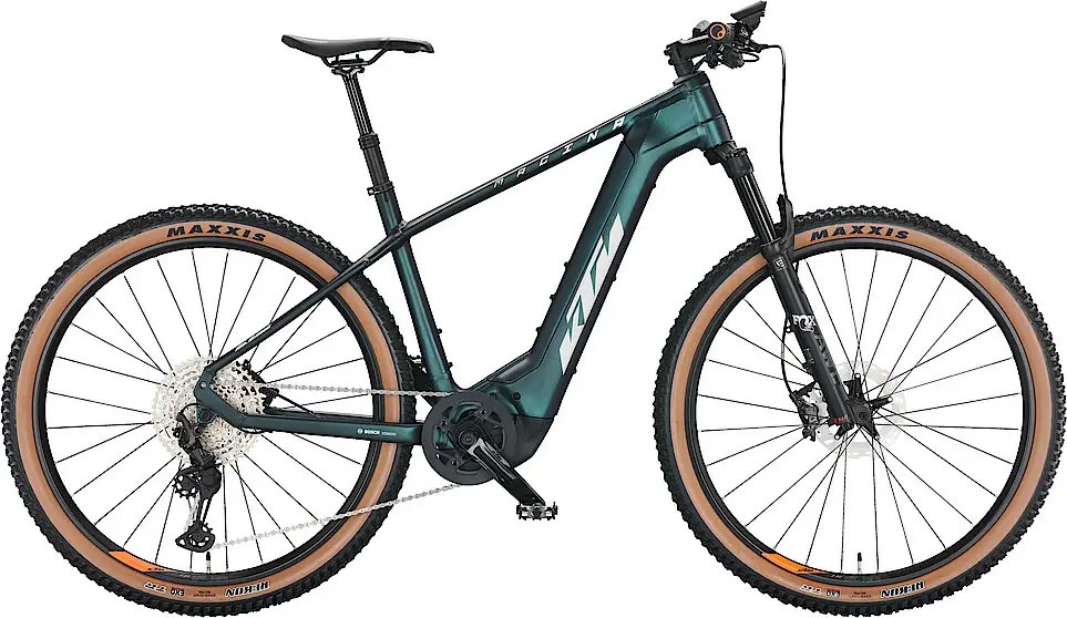

KTM Macina Team 2022
EMTB Forums verdict
The 2022 KTM Macina Team is an alloy 29in trail e-hardtail built on Bosch's then-new Smart System, pairing the Bosch Performance Line CX Gen 4 motor (85Nm) with a large 750Wh PowerTube battery and 120mm of front travel. It is a front-suspension-only trail hardtail rather than a full-suspension enduro bike; KTM's full-suspension eMTB is the Macina Prowler.
2022 was the debut of the redesigned MY22 frame (M-2706) and Bosch's Smart System with the KIOX display, and KTM's Power Tube Top Loader (PTTL) battery access. All the 29in 750Wh models share that frame and geometry, so the differences between the trims come down to kit. The 791 is the flagship with a FOX 34 fork, a Shimano XT 12-speed drivetrain with a 10-51 cassette, four-piston XT brakes and an internal dropper post. The 792 steps down to a Suntour Raidon air fork, 10-speed Shimano Deore and four-piston Tektro brakes with a rigid post, while the 793 is the value entry with a Suntour XCM coil fork, Shimano MT200 two-piston brakes and a rigid post.
  • 791: FOX 34 Float AWL, Shimano XT 12-speed, XT four-piston brakes, dropper post, 23.9kg.
  • 792: Suntour Raidon 34 Air, Shimano Deore 10-speed, Tektro four-piston brakes, rigid post, 24.3kg.
  • 793: Suntour XCM 34 coil, Shimano Deore 10-speed, Shimano MT200 two-piston brakes, rigid post, 25.2kg.
Geometry is moderate and comfort-oriented rather than aggressive: a 68 to 69 degree head angle, a 73 degree seat angle, long 474mm chainstays and reach figures of 400/414/430mm across M/L/XL. Combined with the 750Wh battery and top-loader access, it is set up as a do-it-all trail and touring hardtail.
Prices were quoted in euros for these European-market models, with the 793 at 3,899 euros, the 792 at 4,299 euros and the XT-equipped 791 at 5,099 euros. There is no genuine UK RRP for the 2022 model year, so no pound price is listed here.
