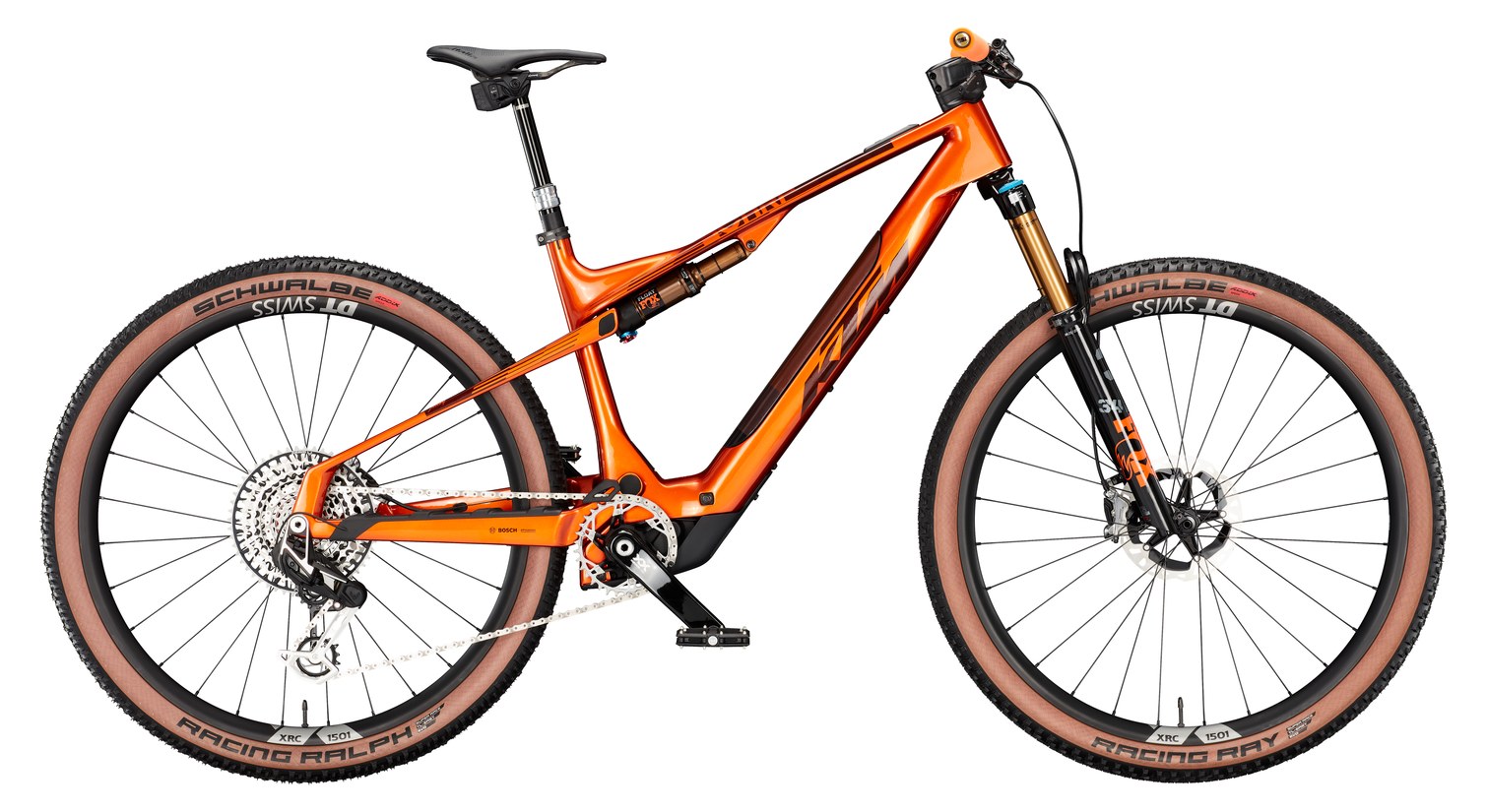

Bike Finder · KTM
KTM Macina Scarp SX
KTM
Macina Scarp SX 2024
DiscontinuedLightweight · TrailLegacy · 2.9/10iFreshness 2.9/10
Motor
Bosch Performance Line SX · 55Nm · 600W
Battery
Bosch CompactTube 400 · 400Wh
Travel F/R
140/140mm
Wheels
29F / 29R
Frame
Full carbon
Weight
16.5 kg
Price
From £5,699
View the KTM Macina Scarp SX on KTM’s site
KTM Macina Scarp SX 2024
From £5,699
EMTB Forums verdict
The 2024 Macina Scarp SX was KTM's first take on a lightweight carbon eMTB, grafting the Bosch Performance Line SX drive unit onto the company's race-bred Scarp full-suspension platform. It pairs 140mm of travel front and rear with a 29in wheelset, and the SX motor is fed by a 400Wh Bosch CompactTube battery that top-loads through KTM's POWER TUBE TOP LOADER and accepts the Bosch PowerMore 250Wh range extender. KTM quotes 55Nm from the SX unit, putting this firmly in the light-assist, cross-country-leaning camp rather than the full-power trail class.
Three carbon builds shared the same frame and geometry. The Master was the entry point at a claimed 18.1kg, running a Fox 34 Performance fork, Fox Float Performance shock, Magura MT5 four-piston brakes and a Shimano Deore XT 12-speed drivetrain. The Prime moved to Fox Factory damping, Shimano XTR shifting with Deore XT brakes and a Fox Transfer Factory dropper for 17.3kg. The flagship Exonic dropped to a claimed 16.5kg with Fox Factory suspension, a SRAM XX Eagle T-Type wireless transmission, Shimano XTR brakes, DT Swiss XRC 1501 carbon wheels and a RockShox Reverb AXS wireless dropper.
Geometry is consistent across the three sizes, with a 66 degree head angle, a 76.5 degree effective seat angle and 451mm chainstays throughout. Reach runs 456mm on the M, 472mm on the L and 499mm on the XL, while wheelbase grows from 1208mm to 1264mm. The numbers read as modern downcountry rather than long-and-slack enduro, matching the bike's light and agile billing.
This model is discontinued. It was superseded by the 2025 Macina Scarp SX, which kept the same Bosch SX platform and geometry but reshuffled the range, adding an Elite tier and revising the build kits.
