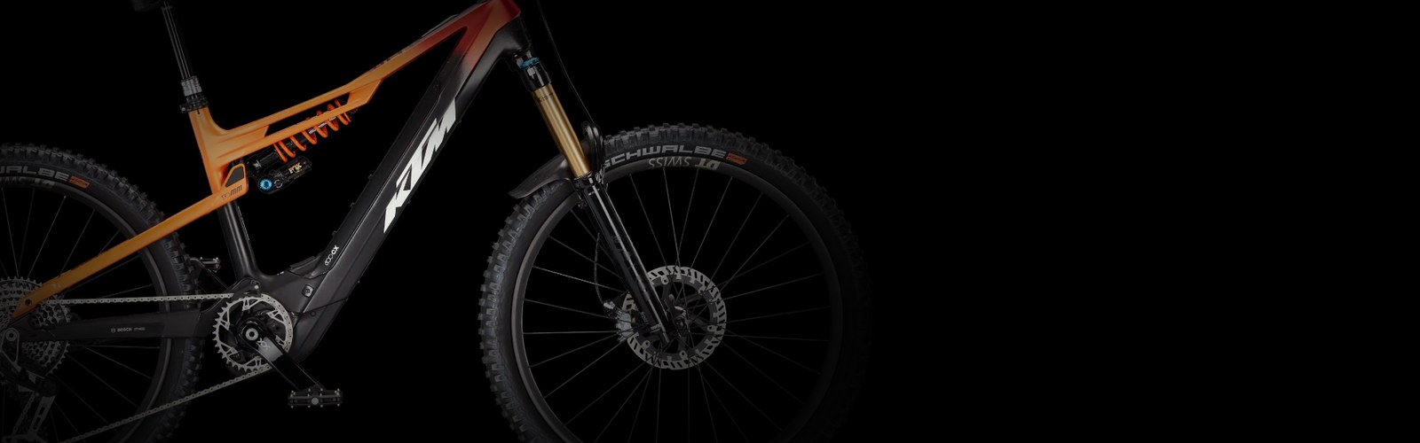

Macina Prowler 2026
The 2026 KTM Macina Prowler is a carbon-framed enduro eMTB built around 180 mm of FOX 38 fork travel and 170 mm at the rear via KTM's Straight-Line-Link suspension. Every trim runs the DiMMiX mullet setup, a 29in front wheel paired with a 27.5in rear, with a slack 64.1 degree head angle and reach growing from 443 mm in M to 483 mm in XL across the three sizes.
The range spans a wide ten-build, four-motor ladder. The flagship Exonic CX-R and Prestige CX-R carry the new 120 Nm Bosch Performance Line CX-R Gen 5 with an 800 Wh PowerTube, while the race-bred Exonic uses the lighter 85 Nm Bosch Performance Line CX Race on a 750 Wh pack. The mid and entry builds run the standard 85 Nm CX Gen 4 (Prestige, Master, Master GX, Elite XT, Elite), with the Elite Di2 stepping up to the 120 Nm CX Gen 5 and an 800 Wh battery. All use KTM's Power Tube Top Loader removable battery.
Value steps are clear within the EUR pricing. The 4,999 EUR Elite undercuts the rest with a RockShox Domain fork, Shimano Deore XT mech and basic 750 Wh CX Gen 4 system, whereas the Prestige CX-R at 8,399 EUR adds the headline CX-R motor, 800 Wh battery, Shimano XT Di2 shifting and an Eightpins integrated dropper for less than the SRAM GX-equipped Prestige above it. Spec choices, not just price, separate the two Master and three Elite builds.
