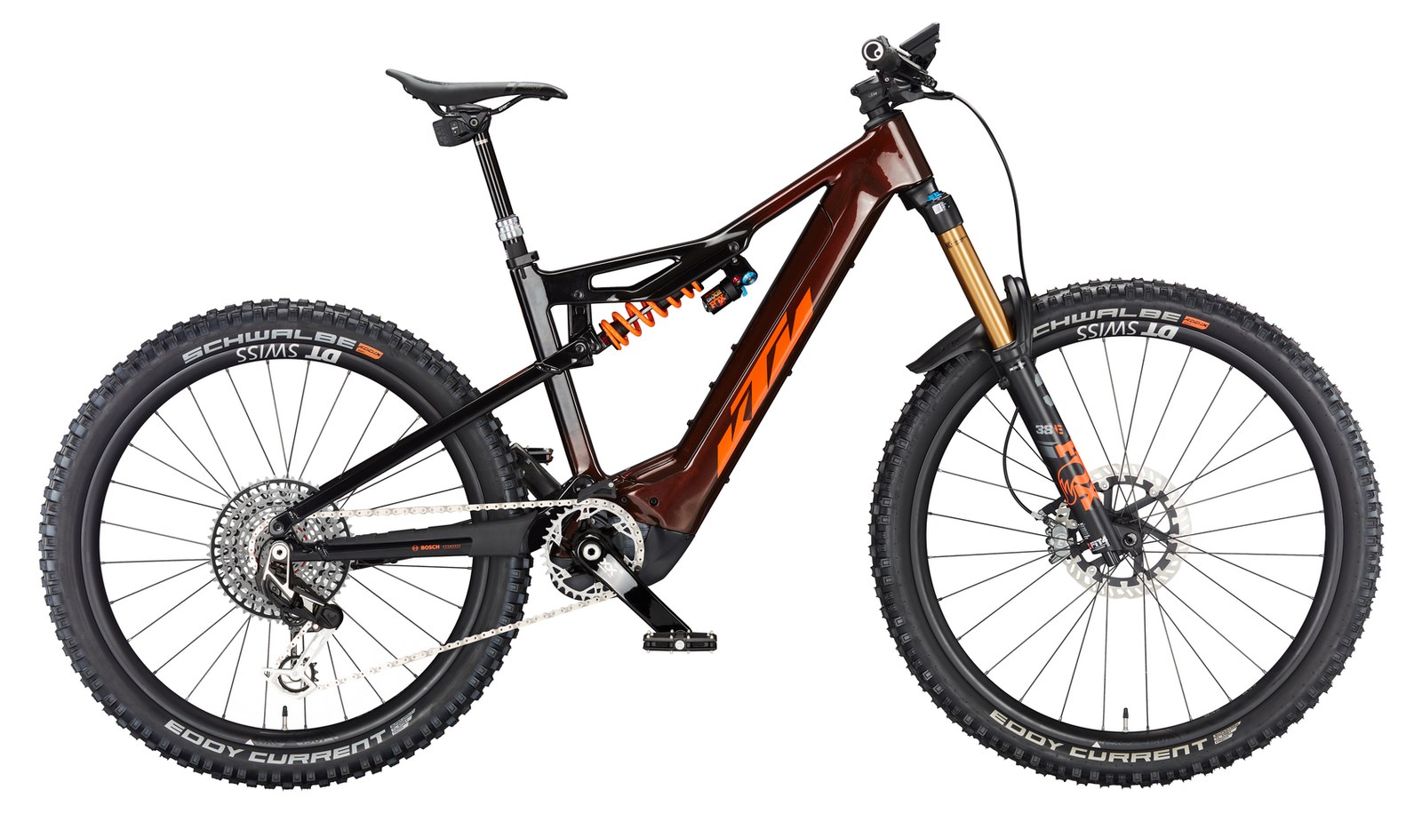

KTM Macina Prowler 2023
EMTB Forums verdict
The 2023 KTM Macina Prowler was the Austrian brand's flagship carbon enduro eMTB, built around a 180mm Fox 38 fork, 170mm of STRAIGHT-LINE-LINK rear travel and KTM's DiMMiX mullet wheel layout (29in front, 27.5in PLUS rear). All four trims share the same Bosch Smart System platform with a 750Wh PowerTube and the 85Nm Performance Line CX motor.
The range topped out with the Exonic, which swapped in the race-tuned Bosch Performance Line CX Race motor, Fox Factory suspension, SRAM XX Eagle Transmission, Magura MT7 brakes and a RockShox Reverb AXS post for a claimed 24.9kg. Below it, the Prestige (Fox Performance, SRAM GX Transmission, Shimano Saint brakes) and the Shimano-equipped Master and Elite stepped progressively down to a RockShox Domain fork and four-piston Shimano brakes on the entry Elite.
Geometry was middle-of-the-road enduro for its era: a 64.1 degree head angle, 75.3 degree effective seat angle and a 450mm reach on the L frame, with consistent 442mm chainstays across the M, L and XL sizes. Schwalbe Eddy Current rubber featured on the carbon-wheeled models, with Maxxis Minion DHF/DHR II on the Master and Elite.
This model year is discontinued and the Macina Prowler has since moved on to newer Bosch hardware, so 2023 examples are now found only on the used market or as old retailer stock.
