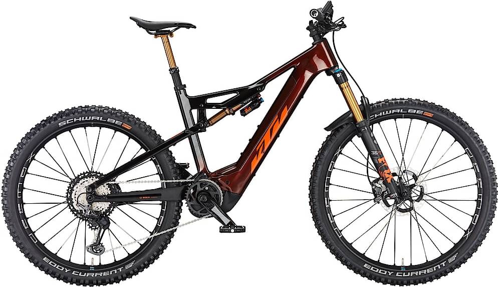

KTM Macina Kapoho 2023
EMTB Forums verdict
The 2023 KTM Macina Kapoho was the Austrian brand's 160mm enduro eMTB, built on the in-house STRAIGHT-LINE-LINK suspension and powered throughout by the Bosch Performance Line CX Gen 4 (85Nm) with the Smart System and a 750Wh PowerTube. Every trim ran KTM's DiMMiX mullet wheel concept, a 29in front paired with a 27.5in PLUS rear, for stability up front and traction at the back.
Six builds spanned two frames. The carbon Prestige, Master and Elite sat near 25kg, topped by the Prestige with a Fox 36 Factory fork, Float X Factory shock and a Shimano XTR groupset. The aluminium 7971, 7972 and 7973 came in heavier at 27.5 to 27.8kg, ranging from a wireless SRAM GX Eagle AXS build on the 7971 down to a SRAM SX Eagle and Suntour-shocked 7973.
Geometry was middle-of-the-road for the era: a 65.3-degree head angle on the carbon frames (66 degrees on alloy), a 76.5-degree effective seat angle and 442mm chainstays across all three sizes (M, L, XL). Reach ran 445 to 480mm on carbon.
The Macina Kapoho has since been discontinued and replaced in KTM's range, so it is now found only on the used market and through remaining old-stock dealers.
