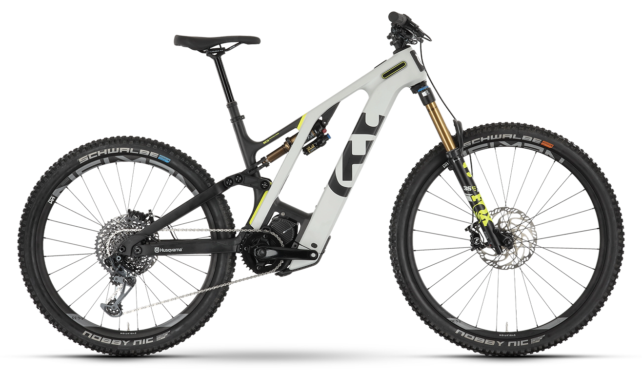

The Mountain Cross MC6 was the flagship of Husqvarna's Mountain Cross range, a full-carbon all-mountain eMTB with 150mm of travel front and rear, a mullet wheel setup and the Shimano EP801 motor feeding a low-slung 720Wh in-house Core S3+ battery. At a launch RRP of 5,999 GBP it undercut much of its competition while still arriving with FOX Factory Series suspension (Float 36 fork and Float X shock), SRAM X01 Eagle shifting and four-piston Magura MT5 brakes on 203mm rotors.
It was sold as a single build, so trim comparison comes down to the cheaper siblings: the MC5 kept the same carbon frame, EP801 motor and 720Wh battery but stepped down to FOX Performance suspension and GX Eagle, while the alloy MC3 used a lower-powered Shimano EP6 and a 630Wh pack. The MC6 sits at the top with the Kashima-coated Factory kit and the lightest Newmen Evolution SL wheelset.
Geometry is on the conservative side for the travel: a 65.5 degree head angle (a full degree steeper than the Hard Cross above it), seat angles that slacken slightly with size from 77 degrees on the M to 76.8 on the XL, and a short 445mm chainstay held constant across all sizes. Combined with a tall stack the result is a playful, manoeuvrable, upright-feeling bike rather than an outright descender. The frame is rated for a 160mm fork for riders wanting a touch more slackness.
This generation is now discontinued, with the Mountain Cross platform carried forward into later model years.

MotorShimano EP801 · 85 Nm
BatteryHusqvarna Core S3+ 720 · 720 Wh
Travel F/R150/150 mm
FrameCarbon
ForkFOX Float 36 Factory, Grip 2, Air, 150 mm, tapered (44mm offset)
ShockFOX Float X Factory, Air, 230x62.5 mm
StemHusqvarna, 50mm length
HandlebarHusqvarna Alloy, 18mm rise, 780mm width
SaddleHusqvarna MTB
SeatpostHusqvarna Pro dropper, travel 125mm (S), 150mm (M-L), 170mm (XL)
BrakesMagura MT5, 4-piston, hydraulic disc
Rear derailleurSRAM X01 Eagle, 12-speed
CrankShimano FC-EM900, aluminium forged, Shimano EP24
ShiftersSRAM X01 Eagle, 12-speed
CassetteSRAM XG-1275, 10-50T
ChainSRAM X01 Eagle
DrivetrainSRAM X01 Eagle, 12-speed; Shimano FC-EM900, aluminium forged, Shimano EP24; SRAM X01 Eagle, 12-speed; SRAM XG-1275, 10-50T; SRAM X01 Eagle
WheelsNewmen Evolution SL E.G, inner rim width 30mm front / 35mm rear
TyresSchwalbe Nobby Nic, Evolution, Super Trail, 29x2.4in front / 27.5x2.6in rear, tubeless ready
Weight23.52 kg
Price£5,999
