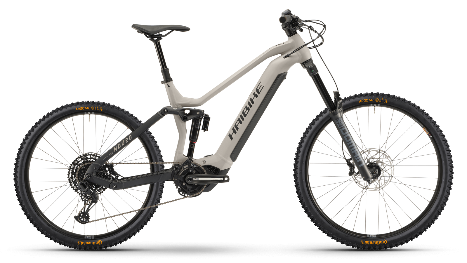

The Haibike Nduro 6 is a hard-charging alloy enduro eMTB built around 180mm of travel front and rear, a mullet wheel setup (29in front, 27.5in rear) and Yamaha's PW-X3 motor fed by a 720Wh in-tube battery. The geometry is firmly gravity-focused: a 63.5 degree head angle, a 77 degree effective seat angle and a long 460mm chainstay across every size point it at steep, technical descents while keeping the rider centred for climbing.
Reach grows sensibly from 425mm on the S to 510mm on the XL, with stack staying tall (644 to 662mm) to suit a descending-biased riding position. It is sold as a single build (the 6) in one urban grey/black colour and four sizes, so the buying decision is purely about fit rather than trim level.
The spec is value-led rather than flashy. A RockShox Domain R fork and Vivid Select shock handle the 180mm of travel, with four-piston TRP brakes on 203mm rotors front and rear providing the stopping power, while the SRAM SX Eagle 12-speed drivetrain and WTB i30 rims on Continental Argotal tyres keep the price in check. A 125mm Limotec dropper and 780mm bar round out a sensibly chosen finishing kit.
