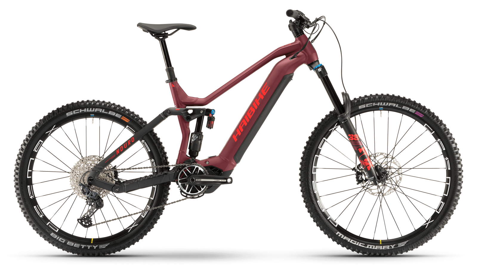

The Haibike Nduro 2025 is a long-travel full-power aluminium enduro and freeride eMTB built on a 180/180 mm Horst-link chassis. Headline numbers: a 26.5 kg claimed weight, a properly slack 63.5 degree head angle, a 460 mm chainstay across all sizes and reach stepping from 425 mm on S to 510 mm on XL. The Nduro 7 trim ships with a Yamaha PW-X3 motor and a 720 Wh battery. The community framing is unambiguous: @R120 lists it alongside the Whyte e180 and Scott Ransom E-Ride as a genuine big-travel bruiser, and it has been called the most capable bike tested in 2023 by some press outlets for sheer descent composure.
Drive system and range. The Nduro 7 uses Yamaha's PW-X3 mid-drive, rated 85 Nm of torque and paired with a 720 Wh pack. The PW-X3 has Yamaha's characteristically responsive top-end and slightly less smooth low-cadence behaviour than Bosch CX or Shimano EP801, but the sheer torque and high-cadence top end suit the freeride-and-shuttle brief perfectly. The 720 Wh battery is competitive for the travel and weight class. Higher Nduro 8 Freeride trims add the Öhlins DH38 fork: a press tester rates the DH38 spec on the Nduro 8 as a clear suspension highlight.
Geometry and handling. A 63.5 degree head angle is among the slackest in the mainstream enduro segment, properly aggressive and signalling that the Nduro is built for steeps. Reach progression is clean and modern: 425 mm on S, 455 mm on M, 480 mm on L and 510 mm on XL, with wheelbases climbing 1245 mm to 1339 mm. The 460 mm chainstay is held constant across all four sizes, which is a missed-trick for XL riders but standard practice on enduro chassis. With 180 mm of travel front and rear and that 63.5 degree front, this is unambiguously a point-and-shoot enduro and freeride machine, not a quick-handling trail bike.
Build and value. Haibike publishes the Nduro 7 at £5599 for the spec on file in the UK at 26.5 kg, with the Nduro 8 Freeride tier sitting above at higher Öhlins-equipped pricing. The value picture is sharper than it looks: a forum noted spec post records the prior-generation Nduro 8 dropping to £4498 then £4199 brand new, suggesting Haibike are pragmatic on pricing and deals can be found. @Zimmerframe notes a 2023 Nduro 8 Freeride 720 Wh sold under £5000 on sale, alongside Mondraker Level R and Crafty R at similar value pricing.
Community-verified strengths. Owners praise three things. The big-bruiser chassis: @R120 places it firmly in the same league as the Whyte e180 and Scott Ransom E-Ride. The Öhlins suspension spec on higher trims, with a press tester rating the DH38 fork specifically. And the simple, robust 720 Wh aluminium chassis at sale prices makes the Nduro a serious value play for riders who want a long-travel rig without paying carbon premium.
Caveats and known gripes. Three honest flags. @chutz666 documents a Nduro 8 motor warranty claim that ran nine-plus weeks with no resolution at 13 months into the warranty period: dealer-network depth and warranty turnaround matter, particularly outside Germany. The Nduro is a heavy bike at 26.5 kg with a 460 mm chainstay across all sizes, so XL riders should sit on one. @ciorbarece7 reports difficulty finding official Öhlins shock-bolt torque specs, which is a small but real workshop friction point. And the Yamaha PW-X3 motor has a smaller post-sale ecosystem than Bosch CX or Shimano EP801.
Verdict. The Haibike Nduro 2025 is the bike for the rider who wants the slackest, longest-travel mainstream enduro eMTB in aluminium and is happy with Yamaha power and a wait-and-see approach to warranty service. If you want top-tier dealer support or the latest 120 Nm Bosch Gen 5, look at a Cube Stereo Hybrid 160 or Canyon Torque:ON instead. Production status is current.
