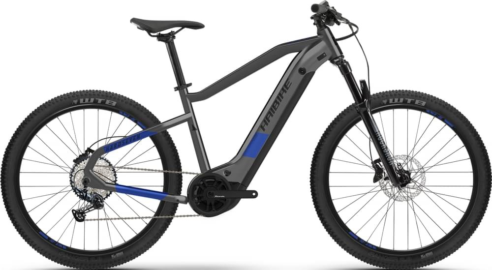

The 2022 Haibike HardSeven is the German brand's mainstream 27.5in aluminium hardtail e-mountain bike. It is a proper hardtail, with a 120mm suspension fork up front and no rear shock, pitched at tours, commuting and light off-road riding rather than technical descending. It is now discontinued, so there is no long-term owner data to draw on and these notes are grounded purely in the 2022 spec sheets.
The seven-strong range is unusual in spanning three different drive units. The entry HardSeven 4 and 5 run Bosch's Performance Line motor (65Nm) with a 400Wh or 500Wh PowerTube. The mid-range HardSeven 6, 7 and 8 switch to Yamaha's PW-ST (70Nm) with a 630Wh InTube pack. The flagship HardSeven 9 and 10 step up to Bosch's punchier Performance Line CX Gen 4 (85Nm) with a 625Wh PowerTube, and can take a Range Extender for up to 1,125Wh in total. Prices ran from 2,199 pounds for the HardSeven 4 to 3,749 pounds for the HardSeven 10 at UK launch.
Componentry climbs sensibly with price: forks progress from SR Suntour coil units on the 4, 5 and 6 to RockShox 35 Silver, Revelation RC and 35 Gold RL chassis higher up, while drivetrains move from 9-speed Shimano Alivio to 12-speed SLX and Deore XT. Braking spans Tektro two-piston stoppers on the cheaper bikes to Shimano four-piston units on the 8, 9 and 10, and the 8 and 10 add a Haibike dropper post. Geometry is moderate and touring-friendly rather than aggressive: a consistent 65 degree head angle, a 74.7 to 75.5 degree seat angle and long 470 to 490mm chainstays across the S, M and L frames. As a used buy the HardSeven makes sense as a dependable, do-it-all trail hardtail, with the choice of trim really coming down to which motor and battery platform suits the rider.
