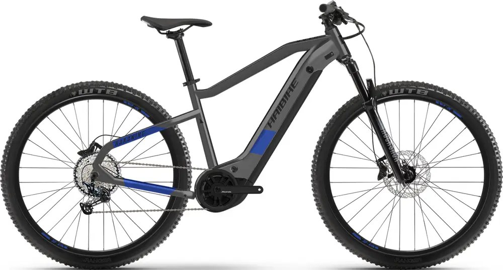

EMTB Forums verdict
The 2022 Haibike HardNine is the German brand's 29in aluminium e-hardtail, a front-suspension-only e-mountain bike pitched at athletic trail riding, tours and cross-country rather than descending or enduro. Every trim runs a 120mm fork and a rigid rear, so there is no rear shock, and all seven builds share the same aluminium 6061 hardtail chassis. It is discontinued, so no long-term owner data informs this write-up.
What makes the HardNine unusual is that the range spans three different drive units. The entry HardNine 4 and 5 use the modest Bosch Performance Line (65Nm) with a small 400Wh or 500Wh PowerTube. The mid trims, HardNine 6, 7 and 8, switch to Yamaha's torquey PW-ST (70Nm) with a 630Wh InTube battery. The flagship HardNine 9 and 10 step up to the punchier Bosch Performance CX Gen 4 (85Nm) fed by a 625Wh PowerTube, which can be expanded to 1125Wh with a Bosch Range Extender. Forks climb from budget SR Suntour coil units on the cheaper bikes to a RockShox 35 Silver and, on the HardNine 10, an air-sprung RockShox 35 Gold RL.
Geometry is sensible middle-ground hardtail: a 65 degree head angle, 75.5 degree seat angle, 475mm chainstays and a wheelbase from 1242mm in medium to 1318mm in extra-large. Componentry rises with price, from Shimano Alivio 9-speed and Tektro brakes at the bottom to Shimano SLX and Deore XT 12-speed drivetrains with four-piston Shimano stoppers and a dropper post on the HardNine 8, 9 and 10. Prices ran from around 2,399 euros for the HardNine 4 to 3,999 euros for the HardNine 10, with the HardNine 7 listed at 2,999 pounds in the UK. As a used buy it makes sense for riders who want a simple, efficient, low-maintenance eMTB for trails and tours and do not need rear suspension.
