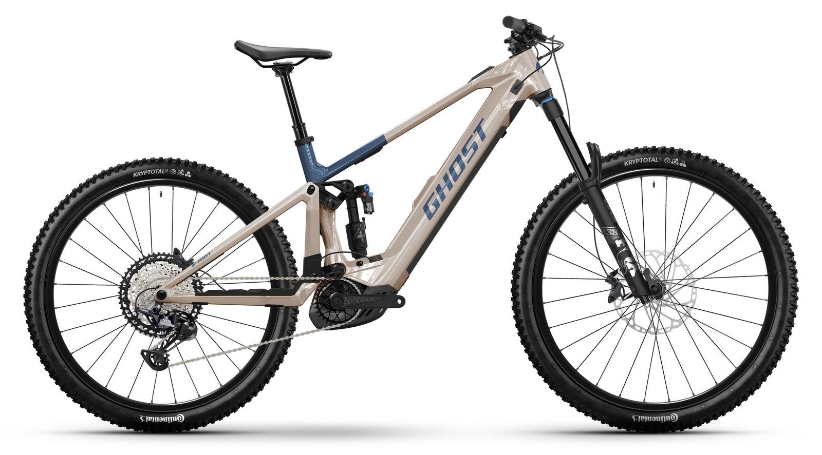

The Ghost E-Riot 2025 is the German brand's carbon mullet enduro: 170 mm fork paired with 160 mm rear travel, the new Bosch Performance Line CX Gen 5 motor at 120 Nm and a 750 W peak, and a removable Bosch PowerTube 800 Wh battery. At a claimed 22.8 kg and £5,499 for the Trail CF entry trim, this is one of the better-priced full-power Bosch CX Gen 5 carbon enduros on sale. Twelve size points across SM through XL give a class-leading fit spread, and a 64.0 degree head angle plants it firmly in modern long-travel territory.

Geometry and handling. A 64.0 degree head angle is the modern enduro sweet spot. Reach is generous and well progressed: 435 mm (S/SM), 465 mm (M/MD), 490 mm (L/LG) and 527 mm at XL on some variants. Chainstays grow modestly from 445 mm to 455 mm, and wheelbase progresses from 1,216 mm to 1,346 mm. Twelve size points (with multiple SM/MD/LG/XL options) suggest Ghost is offering reach-tweaks within sizes — unusual and useful for riders between standard sizes. Tractionlink 2.0 is Ghost's four-bar suspension layout. The mullet 29/27.5 wheel format is standard.

Frame
Ghost E-Riot CF carbon mullet enduro platform; 170 mm front / 160 mm rear travel; Tractionlink 2.0 suspension; 64-degree head angle, 445 mm chainstays; ~23.9 kg
| S | M | L | XL | |
| Reach | 435 mm | 465 mm | 490 mm | 515 mm |
| Stack | 618 mm | 627 mm | 640 mm | 654 mm |
| Chainstay | 445 mm | 445 mm | 445 mm | 445 mm |
| Headtube Angle | 64° | 64° | 64° | 64° |
| Seattube Angle (eff) | 78° | 78° | 78° | 78° |
| BB Drop | 10 mm | 10 mm | 10 mm | 10 mm |
| Wheelbase | 1216 mm | 1251 mm | 1282 mm | 1314 mm |
| Headtube | 90 mm | 100 mm | 115 mm | 130 mm |
| Standover | 764 mm | 761 mm | 760 mm | 760 mm |
| Front Centre | 771 mm | 806 mm | 837 mm | 869 mm |
